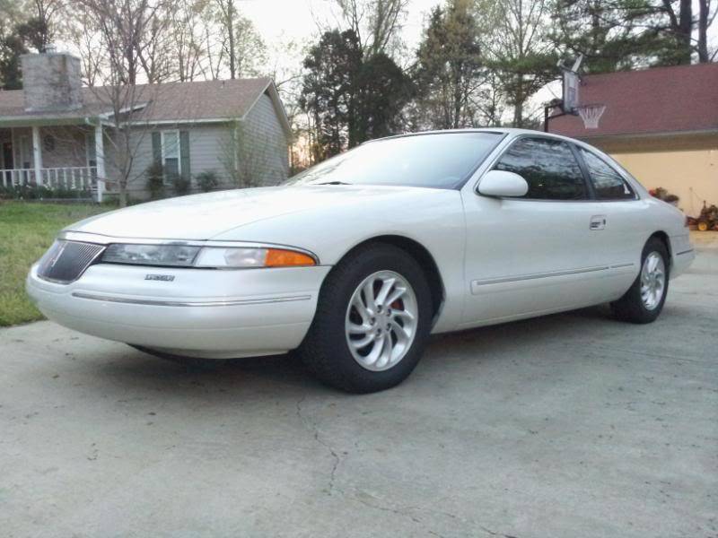

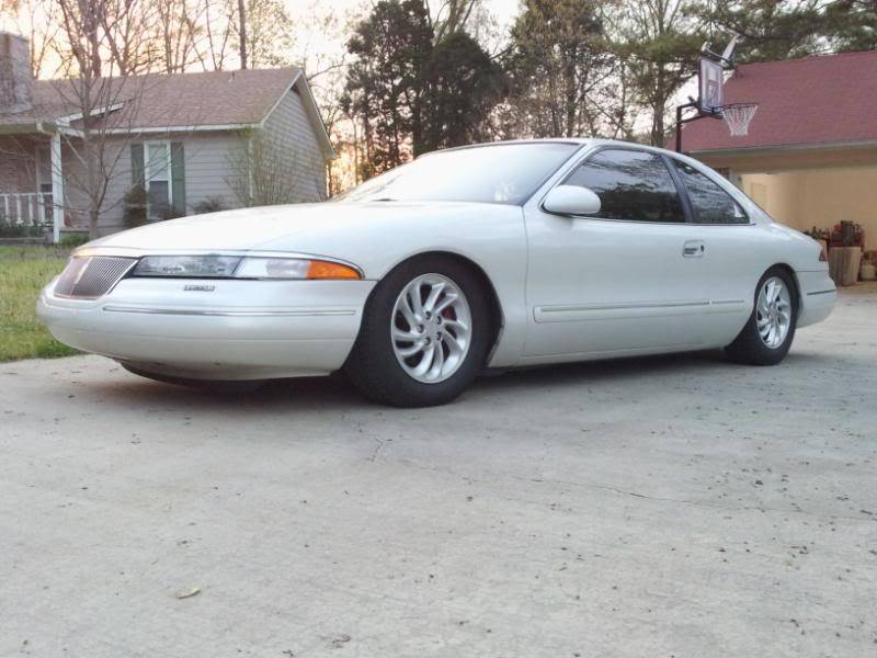

This pic is at a slight incline but the fronts are @ 26" and the rears are at 26.5"~ with a full tank and speakers. W/o them I was just shy of 27". I can fit 1 of my fingers in between the tire and wheel well easily in back, the front has about a .5" gap between the top of the tire and wheel well..
Well my camera and computer are mad at each other.:( My car sits like (nolimit95) in the pic above. Rear tires sit just under the fender and the front sits about 3/4 above the tire. Add an inch to the back and she will be perfect. Ordering the prothane bushings tomorrow. Love the sway bar btw !!! Everyone should get one!!!
Post some pics of different angles of your car, id like to see just hot low it is..I've been wanting to get the American air 1.5" lowered conversion for mine but I'm afraid it will be too low, I've only seen pics of 2 diff cars with them on..
Kevin, see the pic above of sbcaprice's car? That's almost dead on to what you would have with Eddies 1.5 lowered kit. I almost went with the kit myself but I can not bring myself off the air. Show pics of the cars you have seen with his kit on. I might can round up more but the pic above is almost right on the money of the height it would be.
