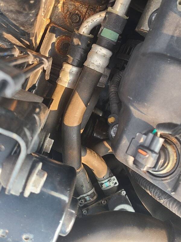

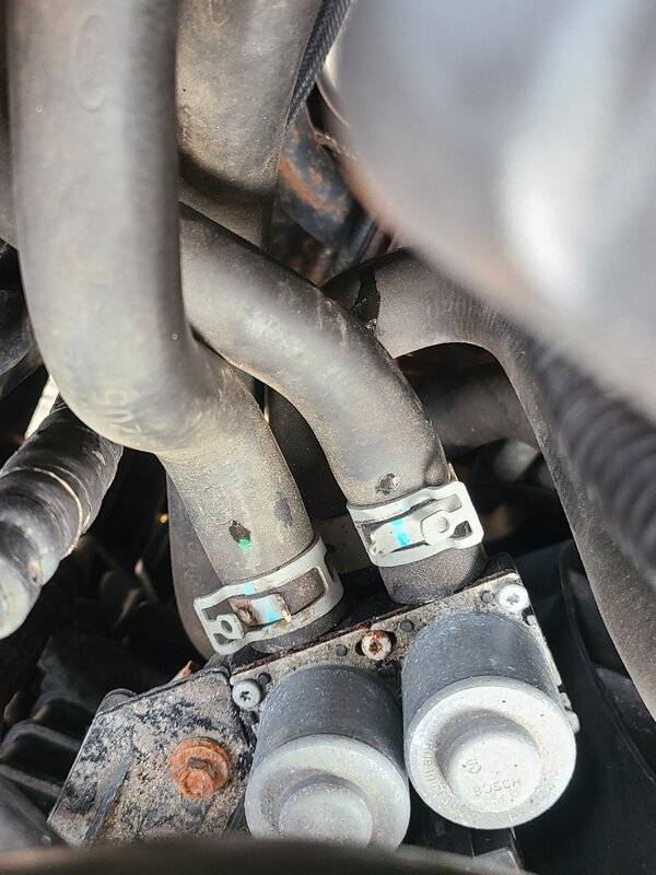

Havent driven my LS in 24hrs. A few hours ago I noticed a big puddle underneath and a good drip coming from above.. realized a big leak sprung out of the DCCV. My heat/AC works perfectly no complaints. Wondering if the hoses are bad? Cant tell really. Clamps are tight. So while I order a DCCV are these hoses still avail? Part #? Guess ill have to see. Does it have to be recalibrated or anything after install? Has been over 100 the past week or so maybe that didn't help..

I guess that it just doesn't really show in the picture.
There's no calibration involved. I don't know if you can still get the hoses and even just the quick connects. If you are careful and only disconnect at the DCCV end, they will probably be okay.
Be aware that the common leak area for the radiator is just above the DCCV. I would suspect it for a sudden large leak. Remove the upper radiator support bracket on that side to get a much better view of it.
On and under the two DCCV hoses/unit itself is where it is soaked and pouring out. Bottom of DCCV covered. Nothing at all from the radiator. Ran the car for 1 minute and its pretty bad. If it was the radiator with a leak that bad Im sure I would see it.

Replaced DCCV it was not the radiator.. I noticed below the DCCV was another valvle or canister of some sort. Not sure what that is? Hope its not nexr.

First time Ive encountered this. The degas wasnt going down. I opened the cross housing cap and went to add some there but it wouldnt take any unless I kept squeezing the upper radiator hose. Took like 20mins. Last time I filled via the cap it took the coolant no issue. I do have a fairly new thermastat though. Rest of the system is 4yrs old. Hoping the aux pump or radiator isnt next. Had I known the DCCV was a weak point also i would have done it during overhaul. Ive smelt a small hint of coolant from that area for about 2yrs along with more than abnormal coolant loss. I guess the DCCV was it all along. Hopefully the fully pressurized system doesnt find a new weak spot. Im weary of the radiator after 16yrs.. left it alone during overhaul as it doesnt seem to be a common issue like the rest of the plumbing but ill probably do it for piece of mind next. I did note that the hoses do not have a tight seal around the plastic housings. Perhaps stretch over time. I replaced some of the old clamps with regular worm gear clamps.
