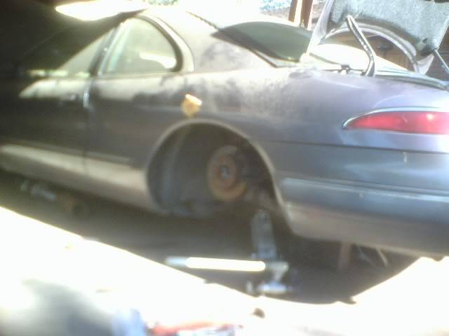

because the suspension is deflecting more. let me see if I can find a pic of my rear all the way up without a wheel.
Here is a pic of the travel on the rear.
Mmmm. I did take that into consideration, but maybe not nearly enough.. That is very true. I might camber in too much with a wide tire. Thanks! I might just have to mod the eccentrics and ride even lowerrrr. Ugh. Poor cats. I can't clear a soda can as is.
