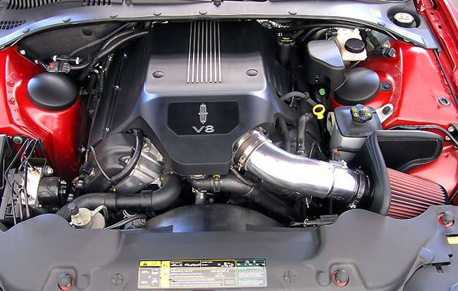

The K&N intake kit will fit the LS directly without any modification. The engine bay in the T-Bird is the exact same as the LS.
It's a simple replacement.
Step 1. Take old stock intake off.
Step 2. Take K&N intake out of box.
Step 3. Put new K&N intake on.
And this is the result:
You guys are alright, thanks a lot for the verification.....like my mind wasn't made up already..... :-)
