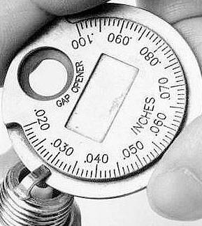

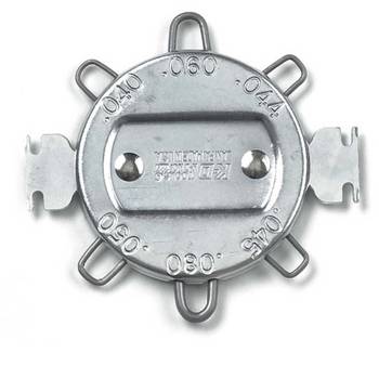

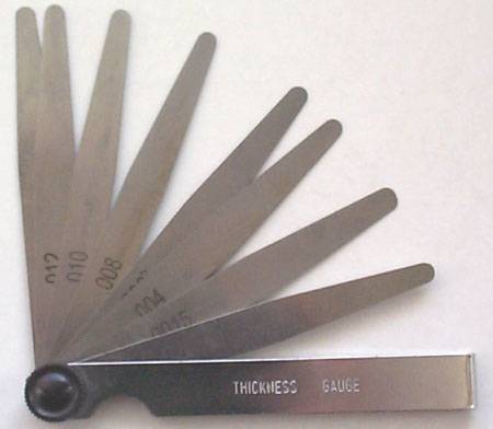

Looking to get one of those old school, feeler gauges,
where you can add several millimeters of blades together to add up to what one needs.
Gonna use that to check or set the plugs.
Knowing that those spark plug rings can damage the tips on the Iridiums.
= BAD !!!
= BETTER
= BEST
