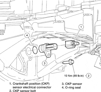

    Been banging my head on this. First I thought it was behind the starter, but now gather it is above the alternator. If that is the case do I need to remove the alternator to get to it, and if so do I need to remove the fan to do so or is there a better way to replace the CPS? Thanks in advance for any assistance and guidance.

    "Position the crankshaft position (CKP) sensor and install the bolt."
    I have both the 2001 V8 and 2001 V6 Workshop Manual given to me by a member on here username DaleGribs ...ask him for it I'm sure he will send it to you ...I can't copy and paste any pictures for you but from what I can see it's right by the CrankShaft pulley

      AmsterDutch, I could not find the member you referenced. I believe you are correct. Where any steps described to replace it?
      Just wondering if I need to pull the fan out.

      It said you could disconnect the crankshaft sensor connector before disconnecting generator/alternator kn rhe engine dismantling...so I assume you wouldn't need to disconnect the alternator at all in order to reach it ...looks like it's right behind the Crankshaft pulley
