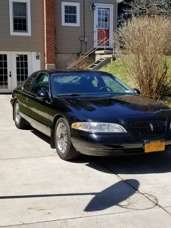

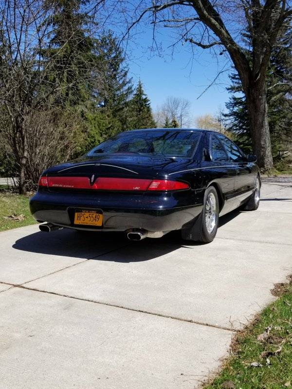

Lowering Car with Stock Bags
I am really hoping it will settle after driving it a while because the rear is sitting pretty high now

Looks great, what size are the wheels/trres ?
Rear are 245/50R17 the Fronts are 225/55R17. The fronts are a taller tire than the rears. The fronts should be 225/50R17 just haven't changed them yet. They don't rub at all.

Yes, this is partly true. This is why I didn't lower the car too much, to compensate for the car lowering at high speeds. I have had this car up to 90 MPH on the thruway around here without any bottoming out. It doesn't ride much differently from my 1990 Mustang with lowering springs.
If you switch to a 225/50/17 you may have a problem with traction control and your M8 not accelerating, due to the difference in tire diameter. Stock tire diameter is 26.6. For traction control to work all 4 tires need to be the same or close to the same diameter.
your 245/50/17 =26.6
your 225/55/17 =26.7
if you change front to 225/50/17 = 25.9 and that may be enough difference for the system not to work - if so, the traction control will turn on while accelerating and slow down the car. I had two different sizes on where the M8 wouldn't go above 35 mph.

When I lowered my '96 Mark VIII (just a base Mark) in the mid 2000's, I had to elongate the the bolt holes for the studs (IIRC) to get the car a little lower, as there was too much gap between the fender and tires (stock tire height on stock rims) and the front/rear at bottom of the stock mount resulted in a rake (hence tweaking the holes). I ran that car HARD on the highway, and it saw tons of prolonged highway usage w/o issue over the years. As far as I can remember, that car was able to hit 130-135 by turning off OD. Car remained stable, despite being a hilly turn pike. Brakes didn't like it, but body/ride wasn't an issue on THAT car ;)
