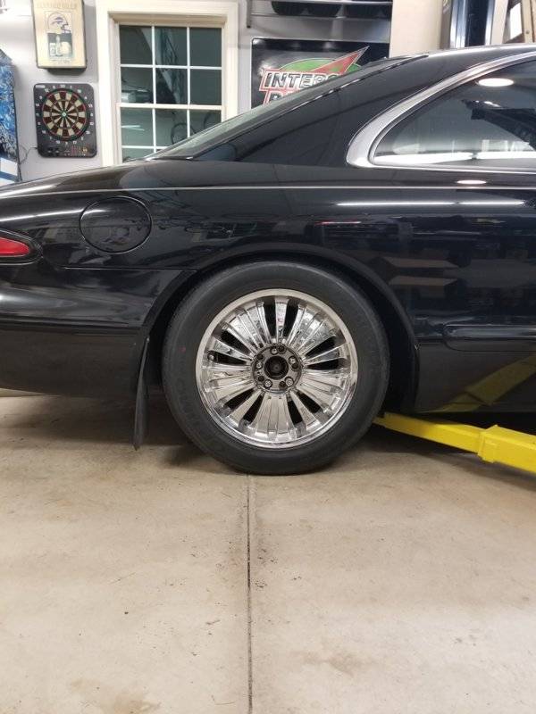

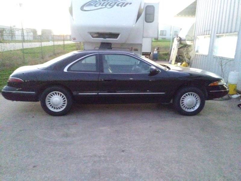

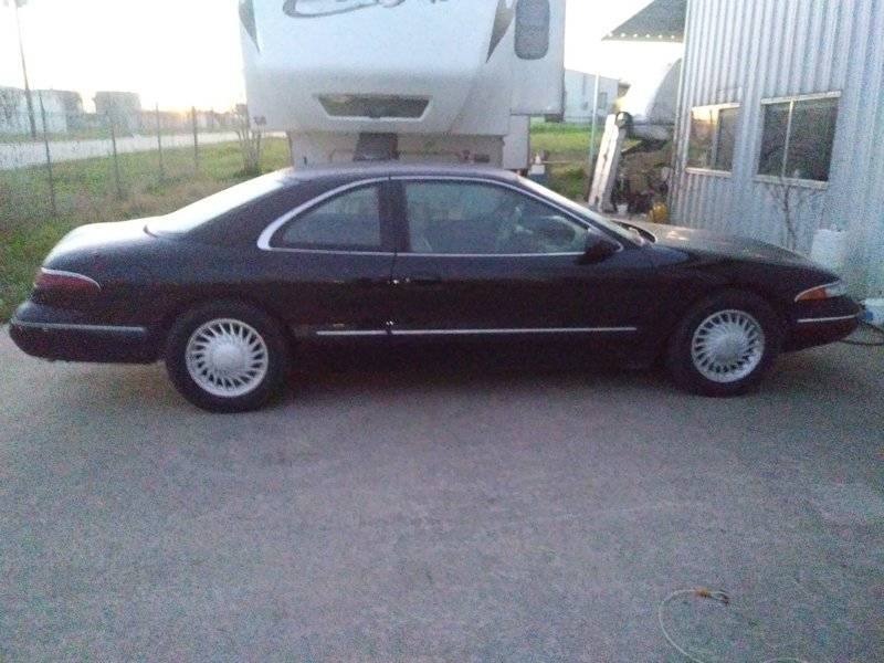

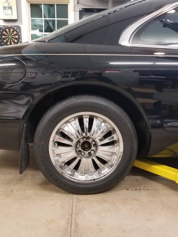

I had just purchased my first Mark 8, a 1993 and it had a ride problem, after finding and fixing a broken ball stud for the left front ride height sensor the car then seem to ride extremely high in front and very bouncy and stiff, I noticed that the lower mounts for the front ride height sensors are slotted so I loosened them and move them all the way up in the slots, then the car was riding too high in the back so I went to the rear ride height sensor adjusted the bracket and slid the ball all the way up re tightened it disconnect the battery for about 30 minutes touch the cables together to depolarize a discharge anything in the ECU and ECM reconnected the battery and took a couple of short drives, now the car is riding level and seems to be riding much better, but where is 123000 Miles I think it Mary still need some shocks. Here are before and after pictures
Sorry about the spell check typos and as you can see by the pictures they are after and before pictures
Here are the back wheels before and after. I'm going to raise it a little bit in the
back. I didnt notice any drop in the front though.
If you ride any of my earlier posts you know I'm a first-time owner of a Mark 8 and by no means an expert on the air suspension but my car didn't seem to react to the adjustments disconnected the battery for about 30 minutes and polarized the ECU/ECM then reconnected the battery and drove it
At one point the front wheel opening was almost 32 inch off the ground and the back was 29, then the back was 31 inches the front was 28, now on level concrete it's it's about 27 and a half inches front end back
