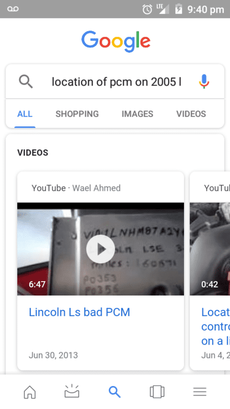

      They say you have to reprogram the replacement computer. Sometimes the cause can be that the Sunroof drains get clogged and water runs down the A pillars, I do believe And shorts the computer,wets the floor etc. This guy was talking a little bit about trouble shooting and replacing the computer. . Just a video to get your research started. Oh by the way do you have a Sunroof?
    • Jaye-One
      Jaye-One LVC Member
      Messages:
      19
      Likes Received:
      Joined:
      Dec 8, 2017
      Location:
      Dayton Ohio
      Sorry accidently hit the post button. Here is the video title on YouTube

      I have s÷n this video thank you. Also never thought about the sunroof leak being an issue for it has been clear and dry weather since ive purchased this possible flood victim from Oklahoma. I hope not. Any pointers on how to tell if this is true and can it be saved etc..
