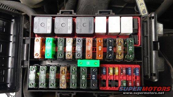

PROBLEM FIXED!! I checked the fuse on the drivers side (the one that is in the dashboard area) and the fuse was good. I brought it to my mechanic and picked it up Friday. It was a FUSE! He was surprised I hadn't checked it b/c we go back 30 years and I have 3 cars that I drive and do A LOT of stuff myself. Apparently there is a fuse in the box under the hood that controls some electronic communication and it was blown. I feel like an idiot. With so much going on with my house build, repairing my excavator, meetings with the bank, etc. I didn't take the time to pull out my dealership Lincoln Mark VIII service manuals to follow the power sequence. Those expensive manuals do me no good if I don't open them. :Bang
I don't know WHICH fuse and I need to post it for you guys so we can avoid this in the future. The shop was closed when I picked up my car Friday and it simply rained all weekend.
Here is a picture of the fuse box with an extra 30 amp fuse. My mechanic replaced the 30 amp that was bad and he also put an extra one in there in case it happens again. So if any of you guys have the same issue as I did, start with checking that green fuse. It's been 2-3 weeks and no problem with this issue BUT my alternator went out a few nights ago. See other thread.

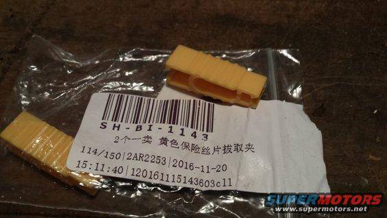

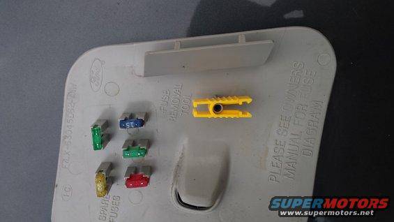

Also, when I checked the fuses on the side of the dashboard by the drivers door the fuse puller was missing. I don't like that. I ordered a couple of fuse pullers off of Ebay and they appear to come from Asia per the Ebay listing and markings on the bag. They were inexpensive and works well. Right now it is a tight fit and it stays on the holder so I hope over time it doesn't get loose and fall into the dash.
