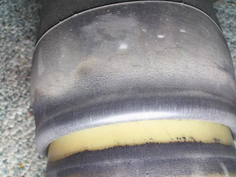

My buddies Mark front end will start to lower a little over night.. not bad but some. Seems about even... is this a sign of 2 bad front air bags, or maybe just a bad line?
One bag is going bad. Has cracks in it. Looks like this.
The entire front drops because one air shock can not hold up all the engine weight by itself. Catch it as it drops and measure both sides. The lowest side will most likely be your leaker.
