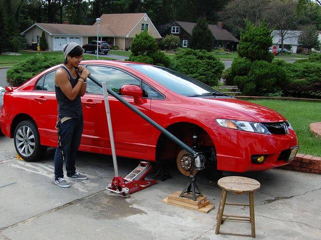

you need this guys tool set
Ok just got home and realized I used red locktite. So my only choice is to try to heat it to 500+ degrees or have someone bring a impact gun and tank over :(
what the hell is he doing.
removing the harmonic balance bolts... i think
