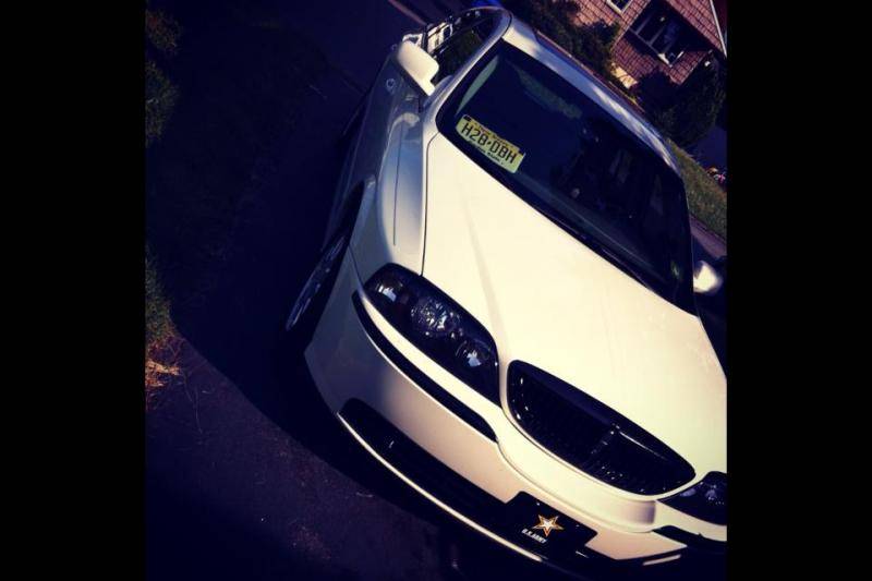

My question is would these fit perfectly on my car (taking center bore, offset, and any rubbing in consideration), i have no lowering springs but would like to drop it 1.5 inches all around so would i still be able to do so after putting these rims in. I have never gotten aftermarket rims before so kinda new to this. LAST thing, do you think these would look nice on my car since I have blacked out my grill, lower grill, fogs, and all trim pieces?

Thank you so much in advance :)

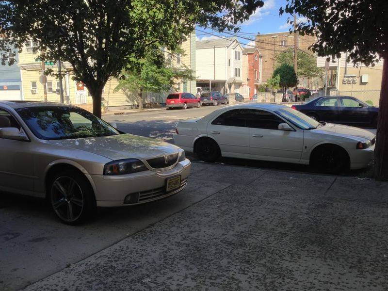

I hate that pic of my car LOL since it was the first day and the springs didn't settle it looks like a damn monster truck hahahaha
