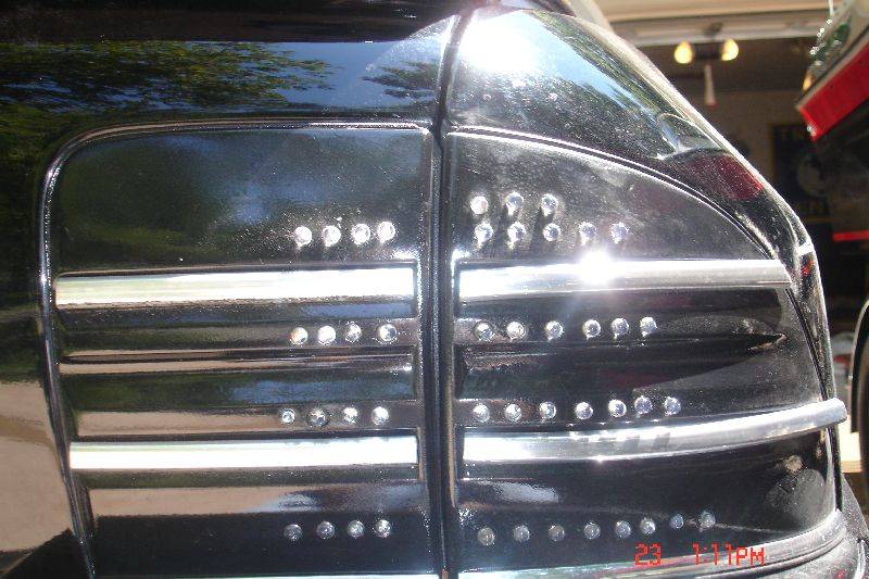

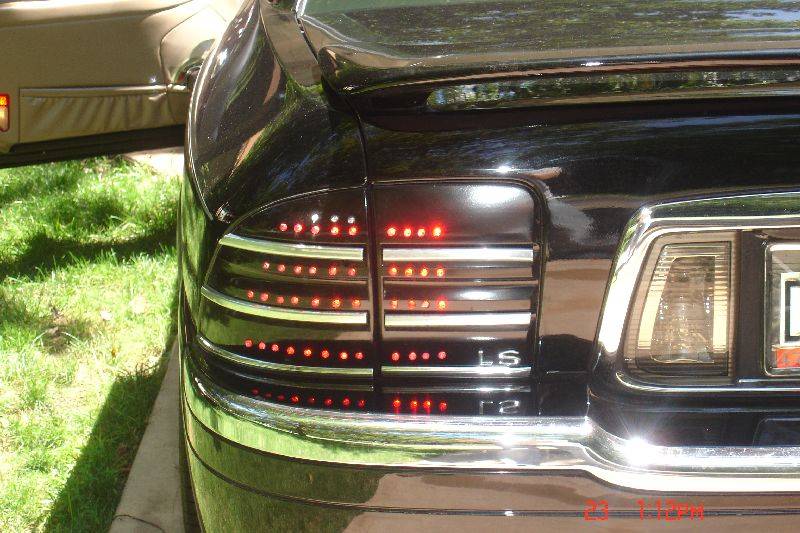

here are the pics of the lights cars really dirty and needs to be cleaned.. lemme know what u think of the lights
Hey man not to sound like i'm giving negative remarks but i think u could of did a better job looks like u just thru it up. Looks like u have some kind of skill so i would come up with somthin else. I like the idea but not the design
I applaud your efforts and originality.
with that said, it's not my taste. Some of the LED's appear to be misaligned slightly, which takes away from the overall look.
And I am not certain the overall brightness/visibility is the same as stock. Personally, I want as much visibility as possible to avoid someone from rear-ending me.
With that said, not my style. But again, I applaud your efforts.
at night these are 10x brighter then the stock taillights. I know some of them are missalgined cause i plan on doing it a better set of taillights these were my old ones which u might be able to see on the drivers side theres a hole from some ass with a pellet gun so i just did this a prototype and will make a better one that is alligined and a different pattern

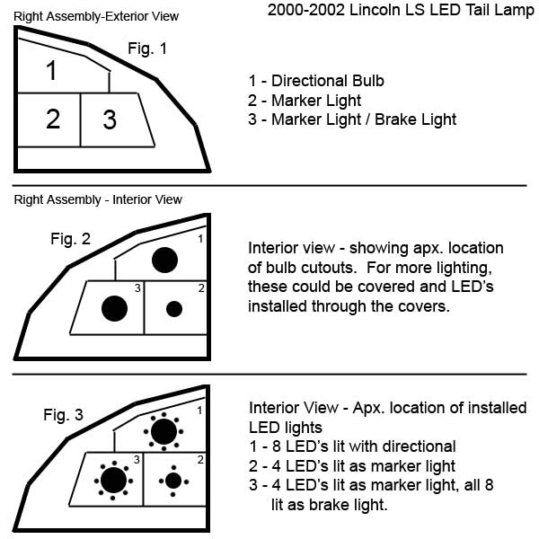

So, I drew up a quick image below of how I think this could work. The problem, as I stated above, is how to have the brake lights and directional lights shine brighter than just the parking lights. Also, the LED's for the parking lights have to be bright enough to see the car at night and in poor weather. And the brake / directional lights have to be much brighter than the parking lights to distinguish them as such.
Help yourself to comments and suggestions.
