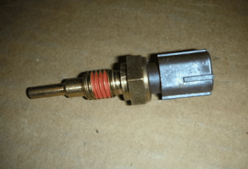

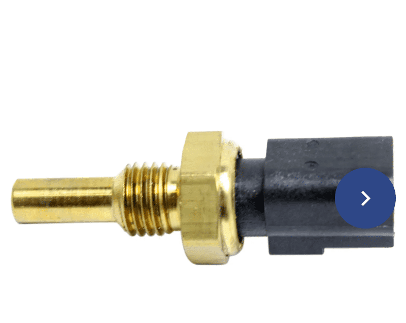

I ordered a new coolant temp sensor the new one that's in the second pic is different threads it will only screw in maybe a thread or 2 then stop I don't want to force it. The old one I pull out is the 1st pic the one with the red sealant on the threads can any one tell what's going on with this it's 2005 v8 someone replaced motor in it a year ago
Is the new plug the same brand and part # as the original? Just by looking at both of them I can see some differences...are the thread size the same?
Look this part number up Xr8f-6G004-AB that is the one with red thread sealer that was in the car. Now the problem I have now is every part store pulls up one for 2005 ls v8 it's the one in the second picture an that one only will screw it a thread or 2 an stop
The 2 sensors you are showing... most likely have a different thread pitch... to prevent installing the wrong sensor in the wrong spot.

I did a part # search with the xw4z part # on Rock Auto... and 4 options came up. One was OEM Motorcraft at $45.
When you went to your local parts store... did you ask for a coolant temp sensor... or cylinder head temp sensor? I'm guessing the goofballs behind the counter don't know the difference.
