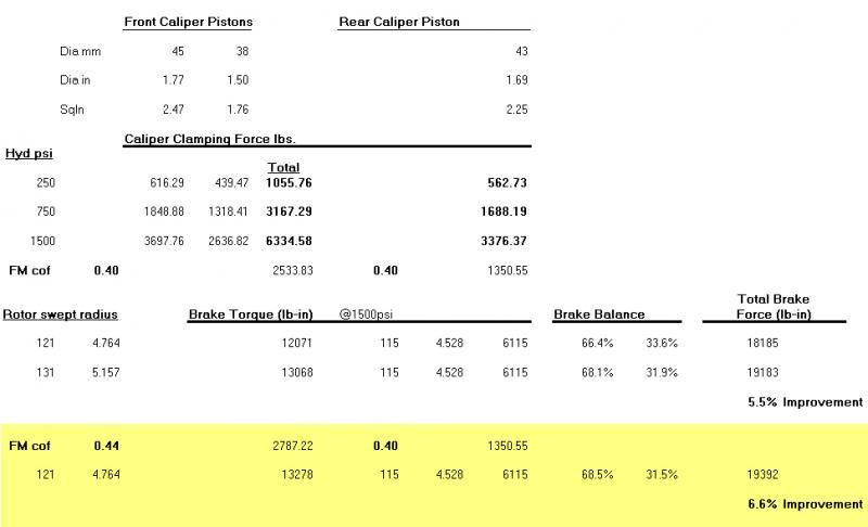

As you theorized what you have done is improve the leverage of the brake vs. the tire diameter, which is always an improvement in braking output vs. pedal effort. I’ve thrown together some shorthand calculations of what you have done in the first table. It’s not detailed so ask questions for what I didn’t explain well.
I’m using a SWAG 0.40 Coefficient Of Friction for both the front and rear pads, which would be within a pad’s Edge Code of EE. Edge Coding is required by a few states, not Federal, and each letter spans a value of 0.10 mu. E is between 0.35 and 0.45. It’s been over a decade since we (I) did the testing on the DEW 98, so the pad’s values could just as well have been within the F range – just don’t remember.
So using those values of the front rotor swept radius (the center of the pad’s relative rotor radius location) by the addition of the 20mm to the rotor diameter you increase your output by over 5%. That’s a good change. Now towards the bottom of the table I show that you could have done the same with a higher COF set of front pads, still within the EE rating, but you would not have gained the additional mass of the rotor used as a heat sink. In addition, you now still can use a higher friction front pad and gain more effectiveness, but with a higher shift towards front brake bias.
It was stated in the thread that the DEW98 has an abnormal rear brake bias – not true! We are used to hearing that the front brakes do most of the work, but that was factored more due to rear brake drums and mechanical proportioning valves. The majority of the vehicles on the road today are disc/disc and with dynamic proportioning through the ABS controller, and only at high deceleration values. The brake bias in most cases is more like 60/40%, so the LS is actually more front biased then others. And in fact I can name off a few vehicles that wear out the rear brakes faster then the fronts. This is mostly due to the aforementioned change towards rear bias and the engineers lack of expectation, designing the rear pads to a lower friction material wear volume then it should have been.

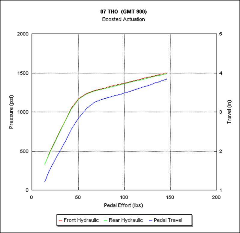

I don’t have access to the DEW 98 booster values anymore, but I’ll use another example that I have, seen in the second attachment.
This is pretty typical for most vacuum boosted vehicles. You get to about 50-60 lbs pedal effort and the booster has exceeded it’s travel so the remainder of the hydraulic pressure output is “manual”, no longer boosted. So past the “knee” the driver needs to push harder and farther to get the increase in hydraulic pressure then he did before the knee. With less displacement due to hose expansion or god forbid air in the lines, the more you are in the boosted zone and getting more hydraulic pressure for a given pedal effort.
Here is the counterpoint – if you want good incipient modulation. The shortest braking occurs with about 5-7% tire slip on the road surface. The tires are talking to you but not locked up. It’s been said and it is true that a very good test driver can beat a vehicles ABS system in stopping distance. He stays in the tires incipient skid region while the ABS is varying the hydraulic pressure though the stages of skid, unlock, incipient and then skid again. The distance is much better then a driver who would just lock the tires, you retain steering control, and the vehicle does not go out of control. But if you are better then the average test driver, and much better then the average person on the road, you want the ability to modulate the braking incipient skid.
That is much easier past the booster knee then before it. Before the knee a change in 100 psi hydraulic pressure may only require about a 4lbs differential while after the knee it would require 36lbs in the graphed example. So in years past before ABS we used to adjust friction material COF to achieve incipient skid just within the knee, where today with ABS most people want very easy pedals to achieve tire skid.
