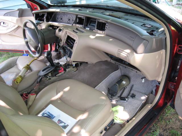

7) No heat in winter...no AC in summer...the old BLEND DOOR problem. Take dash apart replace $5.76 Ford part ....2 days labor. Hey, it was my first one and I need pool time.

9) While battery disconnected 2 days doing blend door fix...(Mucho gracias to whoever posted instructions) noticed front end was "in the weeds"...Don't tell me now front bag(s) leaking???
