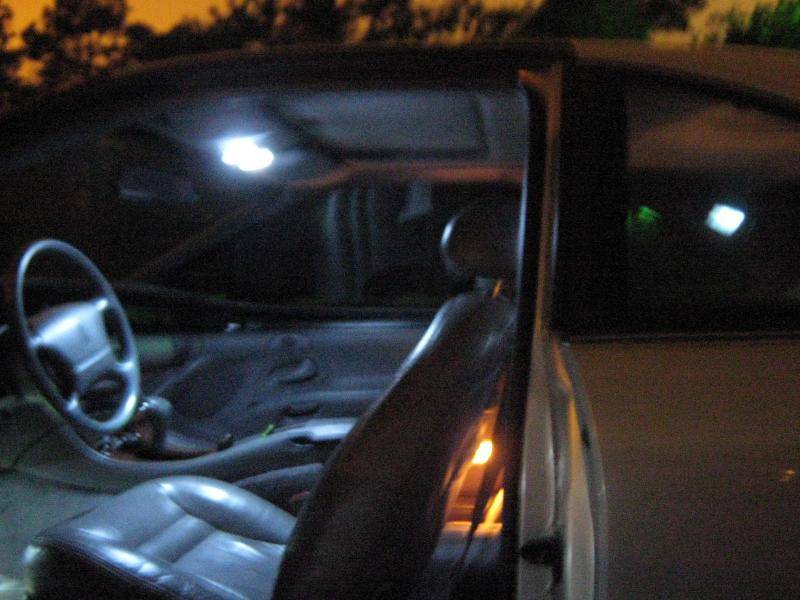

So i saw a thread about changing the interior lights to led's and i have it done. So I thought I would share some pics. Dont know why the pics are so blury guess my cam does not like them.
it does make a diffrence. it was cheap i think i have about 10 or 15 dollars in them. I have a few bulbs left over i will let u get.

That looks good i did my reverse lights and my licence bulb now after seen how it looks inside i wanna do it to mine thanks for sharing.

The cheap 4 LED bulbs on Feebay mentioned above are too dim for my taste. I installed them, then I ordered another set of 7 Bulb LEDs to replace the 4-bulbs. The 7-bulbs look TONS brighter and cleaner.
Thats the deal with buying LED replacements - there can be one LED on it or 36, they all fit in the same socket. So besides price, the differences when shopping for LED's are light output (brightness) and color.
