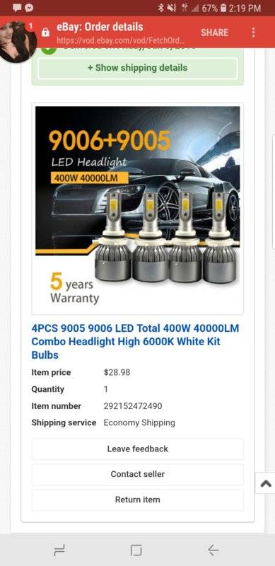

    Screenshot_20180712-141923_Samsung Internet.jpg I bought these on Ebay about 2 months ago. They actually turned out to be exactly as advertised. They are satisfyingly bright. They are plug and play just like they claim. Only thing you need to know is I didn't notice the email they sent me until I went searching for my purchase to share on here that would have been very helpful to know prior to installing. As it turns out the headlights are exactly the same. 9005 and 9006 fit on either light socket. It's the headlights housing that makes them different. ( the lowbeam 9005s go into a socket that has a cover to reflect and spread the light as the 9006 high beams are just that, a beam) In the email they told me about two extra o rings that were in the package that were supposed to go on the 9005s so they lock In place correctly. I didn't know about these and I didnt know it at the time but that's the reason I stripped out both of the 9005 sockets while trying to lock them in place, but that wasnt a big problem. As it was fixed with a little epoxy. That's it as far as standard installation. I actually did a little bit of modification on my gen 1 using a couple diodes I wired the headlights together so that they are both on with highbeams and 9005s alone with lowbeams. I still dont know what the problem is but when I have brights on there's no highbeam indication on the dash, and when I have lowbeams on the highbeam light is indicated. I tried switched the bulbs in their sockets, somehow ended with same results. All in all great installation and worth the 28 dollars shipped. They were also delivered in under a week. The only problem is remembering not to blind people.

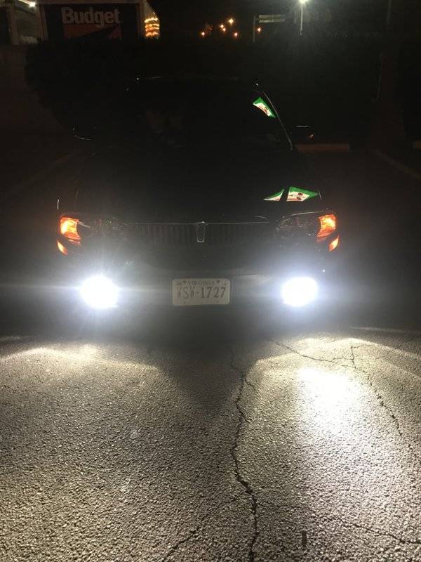

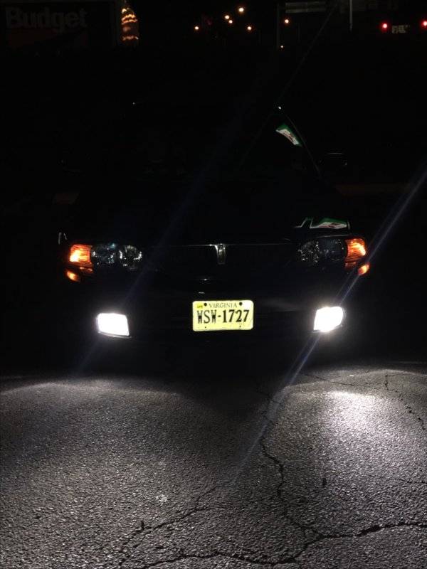

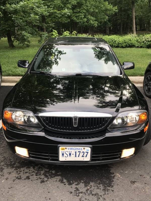

    I use LED Headlights & Foglights on my LS, the Mustangs, and the Mercedes.

    LED Fog Lamps. Halogen Headlights

    They are 100% plug n play. CANBUS is built in.

    Thank you. I guess I wasn't clear though, I was wondering about LED headlights, but I guess you used halogen for those vs LED's. As far as the fog lights, using the LED's do you have any issues with them on a highway as being too bright at all for oncoming traffic?

    No, no problem at all. LED headlight lamps are nothing like HID bulbs that scatter light and blind oncoming traffic.
    Research VLEDS.COM and thier lamps.
    I only use 4300K, Pure White lamps.
