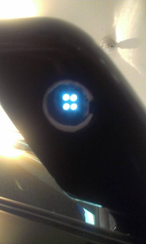

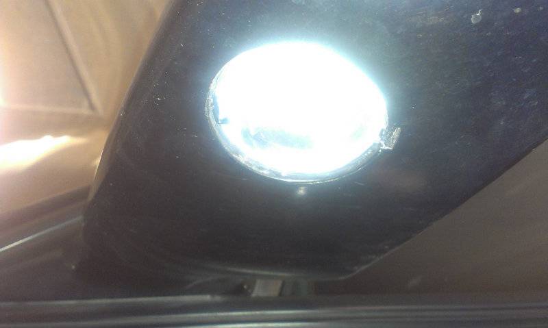

Well I did this yeterday. I decided to rig up a clear lens as well. I ended up cutting up a flexible plastic microwaveable takeout container lid and shaping it to fit over the light housing surface. I used some silicon adhesive to seal it up and waterproof it. I thought I bought clear drying silicon but it turns out it was white. Not a big deal at all since it's not visible unless you squat dow nand look up. As for the light output; its GREAT. I'll have to take some pics tonight when its dark but this bastard glows like a UFO.

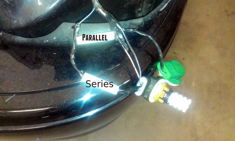

Currently I am fiddling with different resistors trying to get everything to work. I've tried 100w-10ohm/10w-50ohm/10w-25ohm to no avail. Ordered some 25w-25ohm from DDM so they may do the trick. As far as wiring goes the only thing I may have done wrong is wiring them closer to the bulb than Alax did.
Crappy pic:
