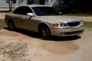

well Tommy you have helped me out too my friends LS might have this issue in the future gilbertls.jpg
