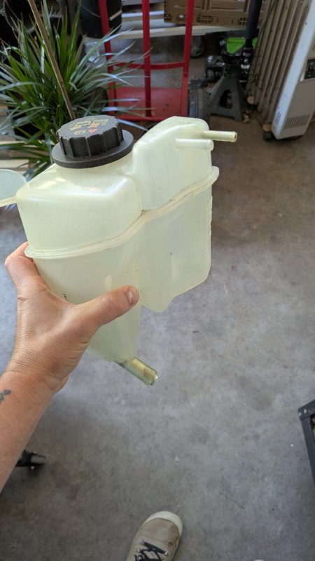

Hey, has anyone purchased an Aluminum Degas Bottle?
I'm looking at this one on Ebay; However, there's no sight glass.
If so, how are you keeping up with measuring coolant levels?
By comparing the full mark on the old plastic one and engraving a mark on the Aluminum Degas?
Appreciate any input because I already spent close to $350 three years ago for the Motorcraft OEM.
I see the price nowadays around $200+
Thanks
There's the Uro brand on rockauto.. They make Jag stuff, so it should be up to snuff. I'm gonna get one.
The aluminum reservoir is significantly flawed. It requires taking to an aluminum welder.
I intend to have the work done, but haven't gone through with it yet.. but here's the deal.
The aluminum jug has two spouts up top and one on bottom, same as the plastic tank.
Problem (besides shitty fitment) is that both of the upper tubes are open to the tank. One is just supposed to be a stub to hang the bleed tube on. So that would need to be welded shut.
Next problem: The upper tube that *should* be open has no straw to go down below the coolant level. This effectively fucks the air bleeding procedure because there's nothing to prevent air from being sucked back into the line.
There are also no interior baffles. This isn't the end of the world, but it requires consideration.
I think that if a second port was added to the BOTTOM of the reservoir, the top ports welded shut, and the coolant line that runs to the top port was routed to the new bottom one, that would eliminate the need for a straw while preserving the air check valve principle. Think bongs. Honestly, the straw design is kinda dumb. The only big perk to it that I see is that aggressive driving wouldn't let air back into the straw unless coolant level was below it..
big drawback to the straw design: air doesn't really *want* to come out of it.
On my dorman tank, the straw's not angled enough. I compensate by lifting (in hand) and angling the tank during the bleed procedure.. gets all the air out a hell of a lot faster and more reliably.
Adding a second spout on the bottom of the tank would require some consideration regarding clearance. Everything on this fuckin car is cramped. But you're following the rationale, yeah? There's little alternative if a bulletproof design is what's sought after. You know, shy of having a part actually made *for you* by a shop that will cnc/3d print (or whatever) aluminum
This makes me think though. I wonder if there's another degas bottle that got remade for a different vehicle (presently working on an 05 explorer with the same flaws, but more revised parts).. this reservoir *could* be relocated. No reason it can't except for space.. I'll start checking aftermarket for other vehicles.
