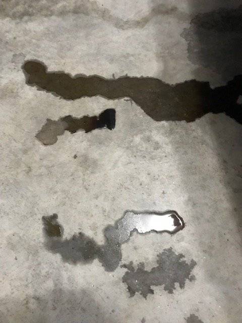

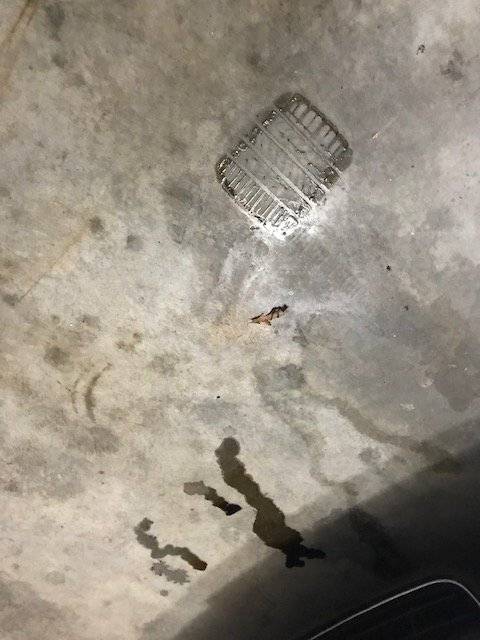

Car has been sitting for about 2 weeks - moved it today and noticed the fluids on the garage floor. Middle one looks to be a mix of oil and something else - coolant ? Bringing it on Friday to get checked out but thought I would ask here for some initial thoughts. In one of the pictures you can see something around where the front right tire was also.

A dark mix of sorts. Could be just water condensation draining from your air conditioning system. The AC unit is usually mounted over the right side of the car. Your tire might have some water,dirt or motor oil that transferred from the inner fender area.
...Could be just water condensation draining from your air conditioning system. ...
After sitting for two weeks? (Otherwise, would have been my first thought too)
My wild guess is that if you take the engine cover off and look at the top of the engine near the front, you'll find coolant.
Appreciate the replies. It definitely has the look and consistency of condensation, except for the small spot in the middle, where there looks to be oil.

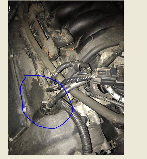

I see something that looks like it could have leaked -picture below
^ That's more towards the front/right of the engine.
Looking at your previous pictures, the drips (based on that spot from the right side wheel), it's coming from further back.
Seems very level with the back of the engine, right about near the firewall.
Motor mounts have fluids. Looks to me like it's right about where the engine meet the trans.
Does indeed look like water/oil mixture. I don't think it's direct engine oil, think it's a drip down from right, back side of engine.

Maybe grab a large fresh piece of cardboard and park the car on top of it for a night or two.
before moving the car, have a look underneath, see if you can pin point, where it's coming from.
It's definitely coming from behind the wheel as apposed to further up the front of the engine.
Your oil level on the dipstick, shows the same blackness of oil color ?
Hopefully it's a bit more golden/brown as apposed to that blackness on the floor.

Leaks at the front top of the engine can run under the manifold to the back of the engine.
Motor mounts have thick dark red fluid that can leak for days.
That is minor oil seepage around a PCV connection in the picture. It would never be enough to drip on the floor.
Took Rigs suggestion to clean up the original fluid and put down a fresh piece of cardboard last night. Checked it this morning and it was bone dry. Going to take it out a lunch today and drive it for a bit and check again tonight. Oil on the dipstick is gold/brown not black. Hard to get under it at the moment, will get in on a lift Friday and go from there.
Joegr - agree oil seepage would not be enough to drip, but was the only area I saw anything close to a leak.
