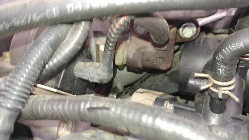

It appears when i got the car running I m leaking coolant out of this brown metal part by the throttle body. I've already replaced all the plastic peices.
That "brown metal part" is the EGR valve. Coolant is not leaking from it. Coolant is spraying there from a leak nearby, then you see it dripping down from there, like in this picture.
It's a plastic part or a gasket. Did you use Motorcraft, or Dorman? You say you changed them all, but it sure looks like 2W9Z-9N499-AC is not new. There's a lot of dried coolant residue on it. It's also possible that you twisted the big o-ring seal between it and the crossover tube. It's easy to do.
Yeah found out its blowing out the back of the big middle seal. I used dorman. I think that was a big mistake. I'm going to order all motorcraft. Nothing like doing the job twice. Guess I should expect that from junk china Dorman.
