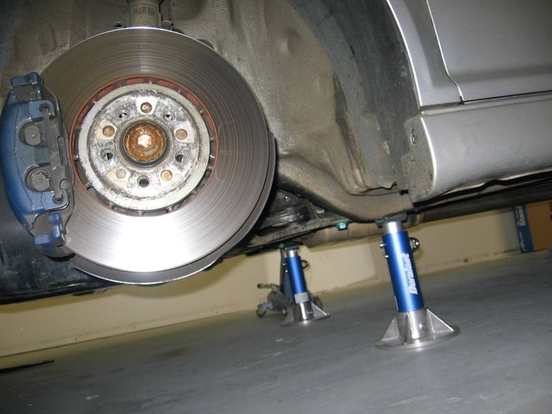

This thread is officialy on jackstands
Looks like it.
