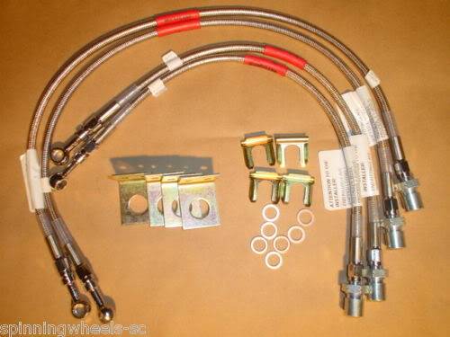

Russel Cobra braided lines $70
Bleed kit and the fance fluid Frog told me to get $80
Machine shop to drill rotors $60ish
So for $550 I will have a Cobra kit with braided lines and the brake bleeder kit I always wanted. :D
Does anyone know if the CObra brake lines will fit?
Well here is the million dollar question. Where do I get Mark VIII braided lines at? Cant find them on ebay or SCP or LMS. :(
I got mine at Classic Tube from Tom.
DLF might know if the Cobra lines work, as he was one of the first to do it and his write ups have been used for ages for us and the T-Birds...
Yeah, I believe in the step by step that I read of his that he had custom ones made. I just did some more research and by only judging the pictures it appears the Cobra line is 2-3" shorter which makes sense because the Mark has much more suspension travel.
After some more digging I found a T-bird kit but they are $160 shipped and the $60 Cobra ones were a better deal. So I guess I will just grind down my banjo fitting and keep the stock lines.
