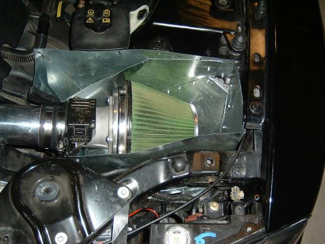

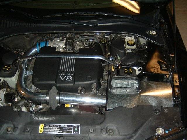

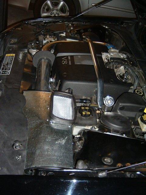

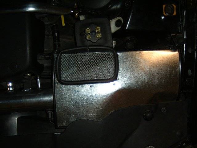

Here are some pictures of the first generation air box for the KKM. Remember these are a prototype but you can easily make one yourself with some aluminum and some time. This may help everyone start one up. As a side note the person that makes my intake tubes made this air box. I've tried to get him to make them for sale but he's so busy with his street rods that this has become low priority for him.
The heat shield on the tube was an experiment. He took it off of his car soon after the picture was taken. However, the heat shield inside the box did show a tremendous temp difference. Last summer when he finished this project he put a high temp thermometer inside the engine compartment and ran it down the road about 10 miles. The temp inside the engine bay was around 190. He then placed the thermometer inside the air box with the heat shield and ran the car back. Once he got out of the car the thermometer was reading close to 110. However, we suspect that the temperature may have been less while driving since more air is being pushed into the box. The outside temperature last summer when he did the experiment was about 87 with 50% humidity. So, it was a hot and humid day to say the least.
