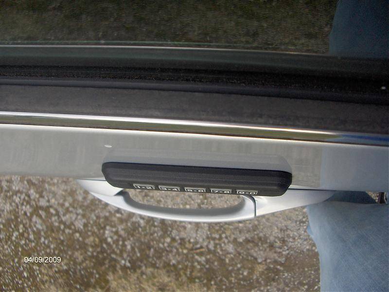

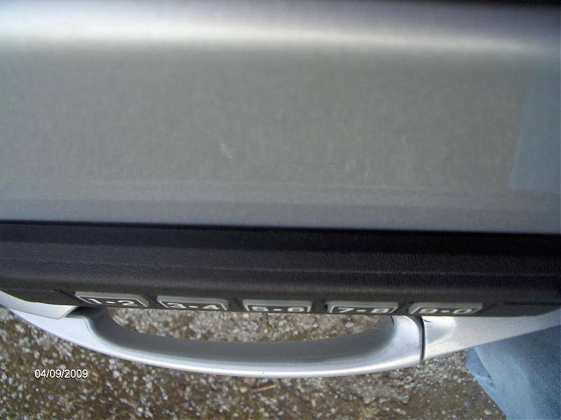

Got somew pics of the keypad for anyone who wants to see what the aftermarket Ford one looks like on the door.

Thanks for the pics. That is a bit thicker than I thought, but still reasonable.
