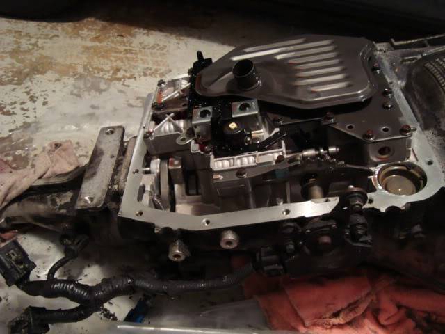

This is a 98 trans that I J-Modded but the MLPS is only held on by two bolts, 8mm or 10 I believe. Not hard to swap at all.

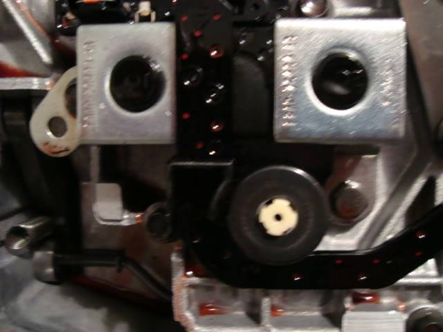

Could be one of these solenoids has went bad. I forgot which one of these two determine it's forward motion but I think the one with the two silver boxes (shift solenoid) and the round one is the pressure solenoid, I think. It's also easy to change but does require a pan drop and average cost is $35 to $55
