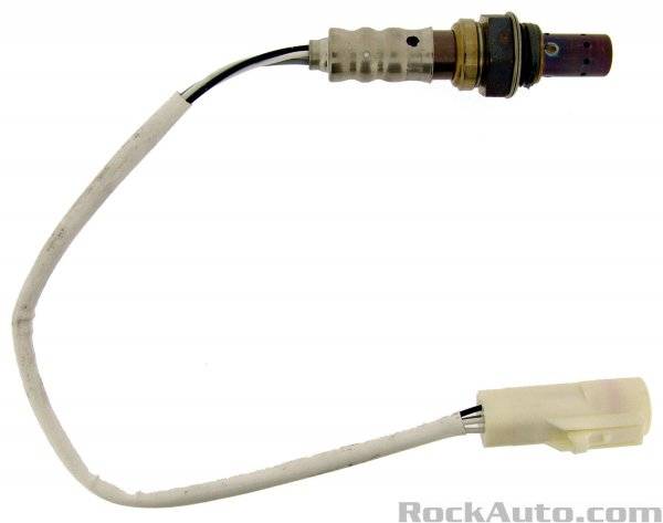

          How and Who confirmed you need new Cats? Before you decide to flip it or keep it you need to make sure 100% that it needs new Cats or just good trustworthy NGK O2 Sensors
          More Information for NTK 22060
          NGK Spark plugs gapped to proper specs
            • Apply a light film of silicone brake caliper grease and dielectric compound to the inside of the coil boots before installation.
          MotorCraft COP's (Coil Over Plugs) Yes they are expensive but these will be a one and done fix
          Last but not least a good synthetic Oil and Shell V-Power® NiTRO+ Premium Gasoline
          The only reason I'm adding my 2 cents is the simple fact I was getting a CEL for the * P0455 Evaporative Emission Control System Leak Detected (gross leak) ...happen to be a faulty fuel cap but it was also triggering P0430 after fixing the p0455 code the p0430 code went away also...ppl jump to conclusions so fast when it could be many things that trigger p0430...it could be leaking intake manifold or leaking coolant ...make sure you diagnose the car correctly before you spend hundreds on CATS!

                          So here's an update:
                          I reinstalled the old upstream sensors that were originally on my cats and all the codes went away. I kept the cheap sensors I got from amazon on the downstream connections. I reset the codes and they didn't come back for 100s of miles. BUT the engine started idling very low (750 RPM) which I knew was not good. When I first bought it the car idled at 1500 RPM.
                          You guys were totally right about using cheap oxygen sensors. It's causing more problems for my car now. When I start it up it has no power and doesn't want to drive. RPMs are super low and it wants to bog out. I have to put it into 1st or 2nd gear to get it driving properly. I am getting a P0301 Cylinder 1 misfire detected and P0316 Engine misfire detected on startup (first 1000 revolutions) in addition to the P0430 Catalyst system efficiency below threshold.
                          Can you guys recommend the right/quality oxygen sensors for this car? Downstream and Upstream. I should've done it right the first time.

                          750 is correct for a warm engine. Even a cold one requires less than a minute before it drops to 750. 1500 indicates a big problem.

                            I also would suspect that the previous owner had coil problems... and drove it that way for a while... which caused the dumping of raw gas into the CATS... and is why you are getting catalyst efficiency codes for the converter. The previous owner probably unloaded the car when he/she got sticker shock from new cat prices.
                            Aside from this... I will add that cheap parts and shortcuts never work out well for the LS... or the owner.
