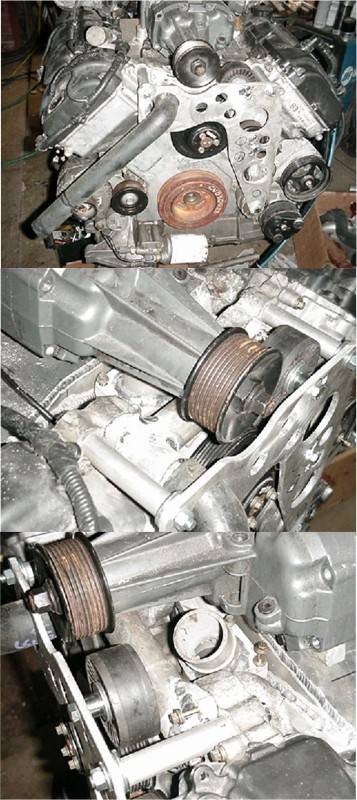

Well - here's the e-mail I got last night... sooooon
From: ATSTurbo@aol.com [mailto:ATSTurbo@aol.com]
Sent: Thursday, July 07, 2005 10:35 PM
To: Lou Senko
Subject: Re: SuperCharger for Lincoln LS
LOU,
THOUGHT YOU MIGHT LIKE TO SEE THE PROGRESS I HAVE MADE. BOLTED THE '01 LS HEADS ON THE BLOCK (PART NUMBER IS THE SAME FOR THE BLOCK), AND TRIMMED THE NECESSARY SECTIONS OF THE MANIFOLD. WATER TEMPERATURE SENDER WILL BE REMOVED FROM THE HEAD AND MOUNTED IN THE COOLING WATER PASSAGE IN THE RADIATOR HOSE HOUSING I MADE. THE HOLE IN THE HEAD WILL BE PLUGGED. SHOULD BE DONE IN A FEW DAYS. PULLEY ROUTING AND IDLER SETUP IS DONE, AS WELL AS WATER PIPES, ETC. FIGURING THE THERMOSTAT LOCATION OUT NOW. THEN PORT & POLISH THE MANIFOLD, SUPERCHARGER, AND PAINT & BOX IT.

What type of supercharger is that it looks like an eaton, and did he send any info on mounting modifications?

right - the plan it to offer it with and without the SC itself - so people can buy them off e-bay or re-builders and such. It will keep the costs down.
It is built to fit the Thunderbird 3.8L M90 right-drive SC.

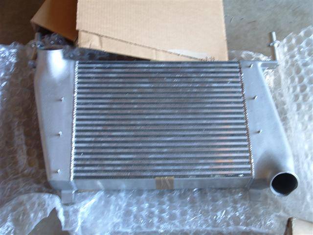

As far as your intercooler, PM me and I will steer you in the right deirection for a Front Mount designed for the Supercoupe. It will look like this one on my SC:
Frogman - this is nothing new. Clearly you have to match the output capibility of the blower to the requirements to the engine... what's why they make different size blowers - right?
The idea is we are going to run 5psi on Stage 1.
Stage 2 - 8psi with the Snow Performance cooler.
Stage 3 - forged internals and such.....
I'm not likely to go past Stage 1 myself (yeah - I keep telling myself that...) but clearly at the 5 to 8 psi level the M90 will handle that low level of flow.
