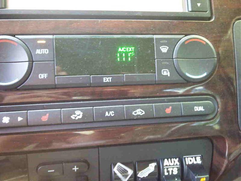

Though under hood temps get warm pretty quickly when you leave you truck on high idle for 3 hours in the sun.
Auxiliary Switches. Known as Upfitter Switches by FORD. They are designed to supply power to whatever the end user wires into them.
The Left one turns on the 3 Watt Wilson Amplifier and Cradlepoint MBR 1000 WAN router. The Amp is there to boost the cellular data card's signal. WiFi going down the road at 65 is fun. Especially when you have people hanging out around you on the highway trying to figure out where the hell the Encrypted WiFi Signal is coming from.
The 2nd one turns on flood lights.
Third one, as it says... more lights
Fourth one kicks up the idle to 1200RPM and holds it there. This is recommended when idling a diesel for more than a few (3-5) minutes, in order to prevent Wet Stacking, a condition that diesels suffer from when idling. It also helps with burning all of the injected fuel, so as to not let is seep down the cylinder walls and thin out the oil in the crankcase.
The + and - marked buttons are to the built in Brake Controller (Tow Command).
