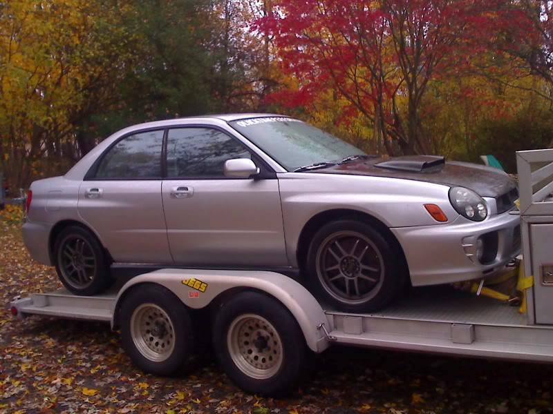

I'll try to explain it as best I can. Car is a stock JDM STi swap with a Front Mount Intercooler and a 3" Turbo Back Exhaust with a cat no less. I took it to Englishtown and pulled a 16 sec quarter at like 87mph
Kept going back taking advise from other WRX owners on how to go faster. Eventually I was launching at around 6000rpm and flat foot shifting (as in never let off the gas just stab the clutch) all the way to 5th gear. So I got it to do a best of 12.51@109.9 pump gas with the AC on every time. I missed 5th about 4 times cause it's a hard shift that fast and I ground the hell out of 5th to the point you couldn't shift into it anything over 3000rpm.
So I got a sponsor and he gave me a header that I was supposed to dyno my engine with stock manifold and then header. Unfortunately I hurt my turbo so I got a way bigger one so no A/B comparison. Also since I was still stock clutch it slipped right away so I was back to 14 sec quarters. Made the mistake of getting an Exedy Carbon Clutch for $5000 and it slipped pulling a 12.8@118
Then got a Tilton Ceramic Twin disc clutch and broke that one too! Tilton warrantied it but the car sat at the shop for 2 years (the Mark stepped in as a driver). So I went down and he showed me how bad I screwed up that trans, I destroyed 4th syncro and 5th. So 3rd and 4th are a paired gearset and so are 5th and 6th so I got them all new since they are paired and also upgraded the syncro's.
