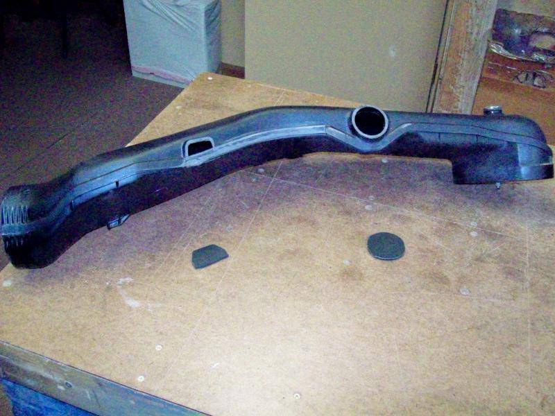

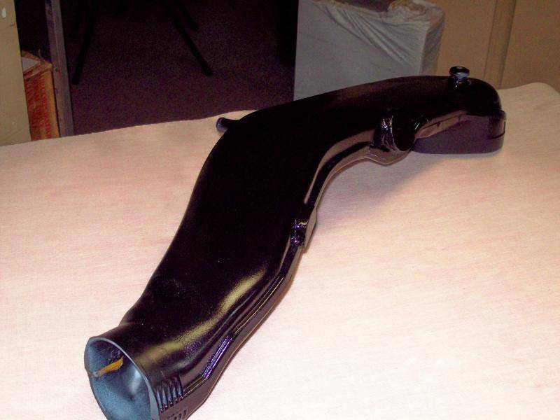

If you have a gen 1 do this. I notice a BIGGGgggggg difference

Throttle body is the most restrictive point. As stated, the stock box works very well! The intake tube mod is just for sound.
Forgive me but did you mod the intake tube or is that a new tube all together? Im new to the 4v motors all together not just the mark 8.
