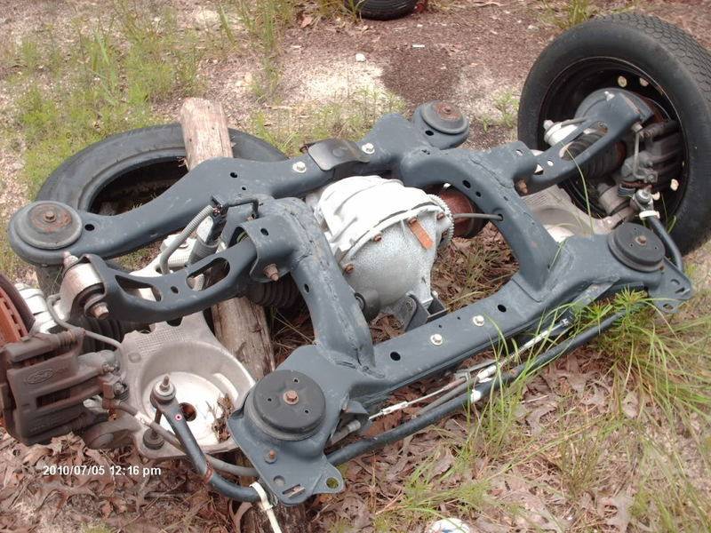

I bought an entire IRS sub-frame from a 1998 LSC off Craigslist for $100 and I'm in Florida so it didn't have a spot of rust on it (well, a little on axles, rotors and tag where I had it sitting outside for awhile). I used a HUGE impact and those bolts came right out without a problem (a 1/2" impact wouldn't budge them in my case).
They may have come out, but you stood the risk of spinning the backing nut in its holder.
Which leads to holesawing your trunk floor.
Mine on the other hand broke loose with a simple 1/2 breaker bar. I love rust free cars.
