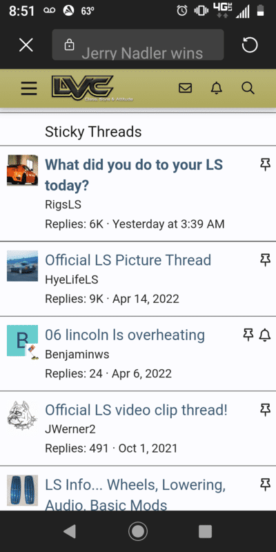

Yup... should have done some research before buying... or come here first.
Lot's of threads on here about the cooling system. One is even a "sticky" at the top of the LS page.
