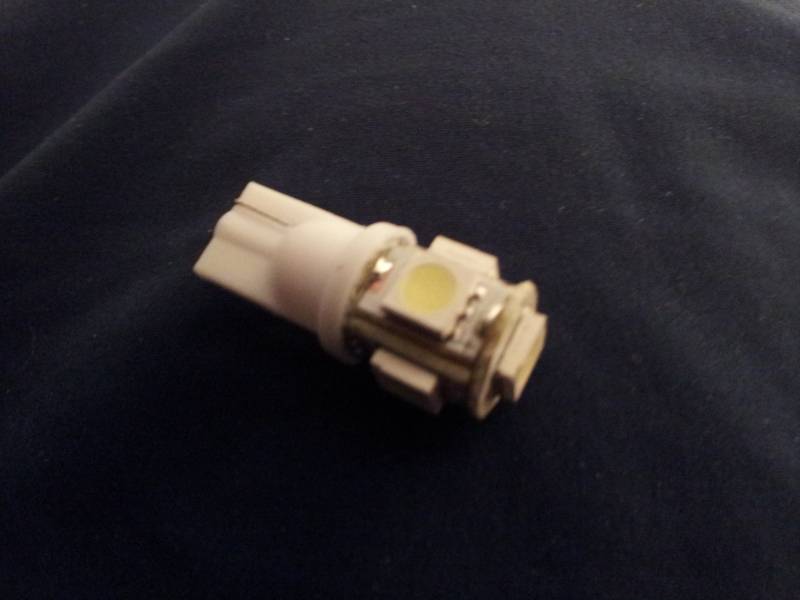

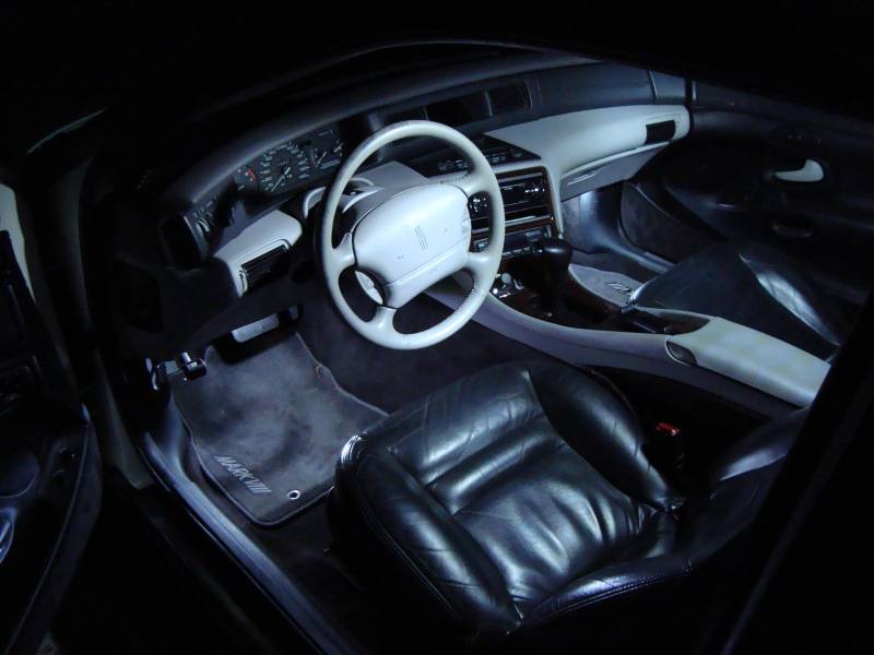

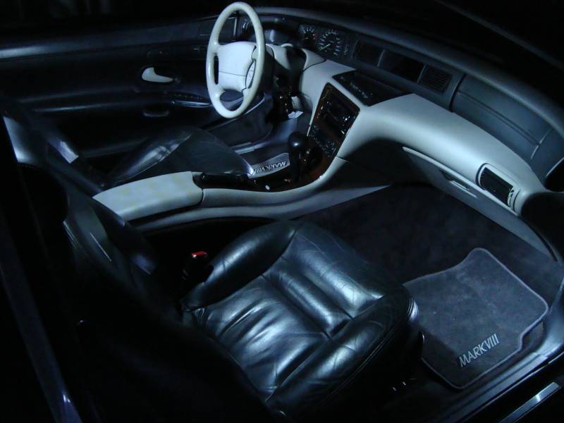

Those are normal LED's and your sylvania super brights will probably be brighter than those. SMD LED CREE would really put out back there. I done my interior with all 194 SMD LED's. All of them are 5 SMD, except for the two in the rear side panels and they are 9 SMD LED's. Turned out to be pretty bright in there.

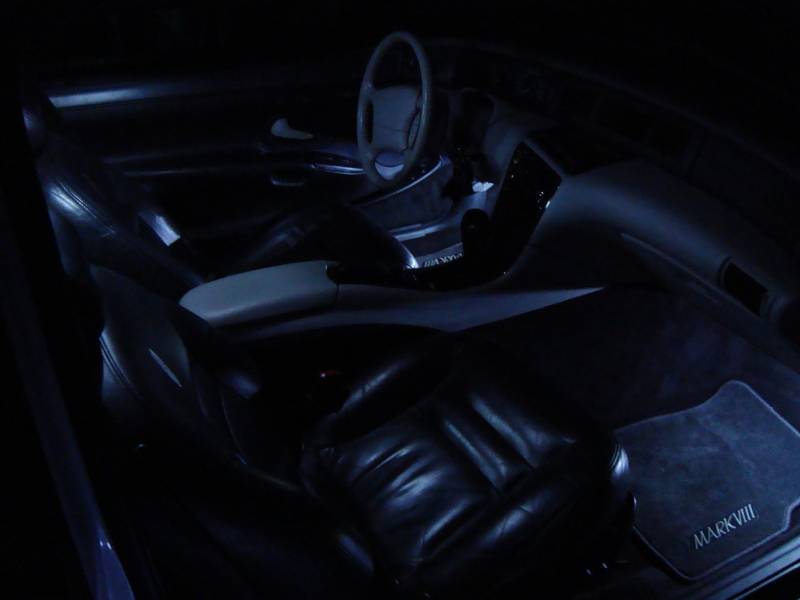

This pic is without the two map light switches turned on, so two of the lights aren't even on.
All light is coming from SMD's like this.
