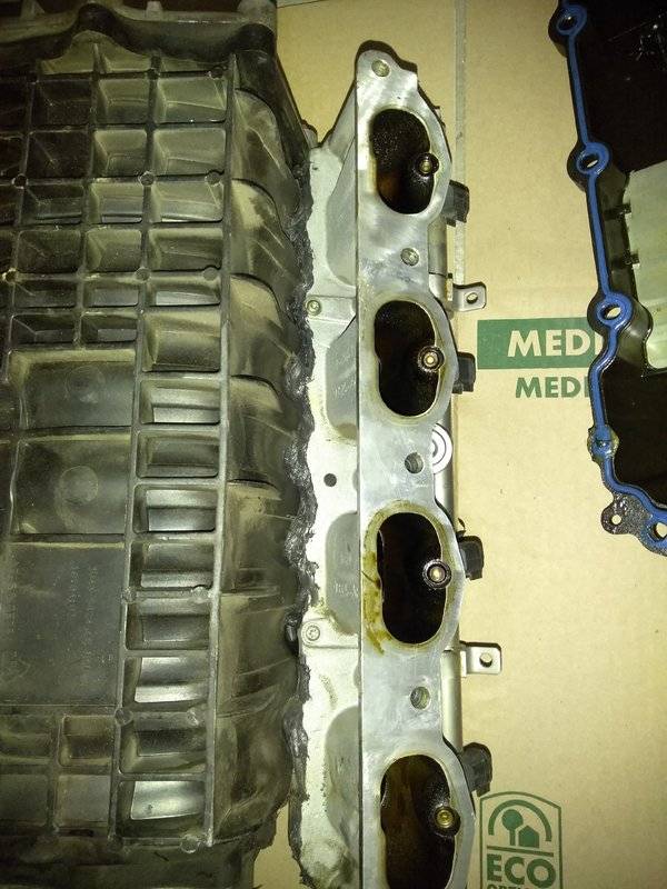

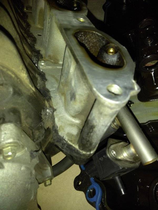

Good evening. I am in the middle of doing the cooling system, as well as manifold gaskets. Everything came off ok, almost to easy. When I got the manifold off I noticed one side was completely caked in rtv (see photos)
My questions are
1. Do you guys think this is hiding something, perhaps a leak that couldn't be fixed?
2. Is it worth it to crack it open and replace the upper gaskets or just leave it? (Don't really want to do this)
3. If I were to get these apart how would I clean off all the old rtv without ruining the plastic or aluminum?
Thank you in advance for the input.
-Tim
clean it all off and check it out closer. im not sure why there would be gasket sealer there unless there was some sort of a crack maybe done by yanking up on the opposite side while not knowing the other side still had a bolt in it. Clean it up and see what it looks like.
What would be the best way to clean it all off?
I'd say either leave it as it is, or take it apart and replace the gaskets or re-RTV them.
You may risk damage to the intake if you take them apart, depending on the RTV they used. After taking the screws out, I wouldn't pry too hard to try and get the metal sections off.

I don't know what solvent to use, and we don't know what kind of RTV was used either. I think that either you can peel it off or you can't. Throttle body cleaner should be safe to get the dirt and grime off.

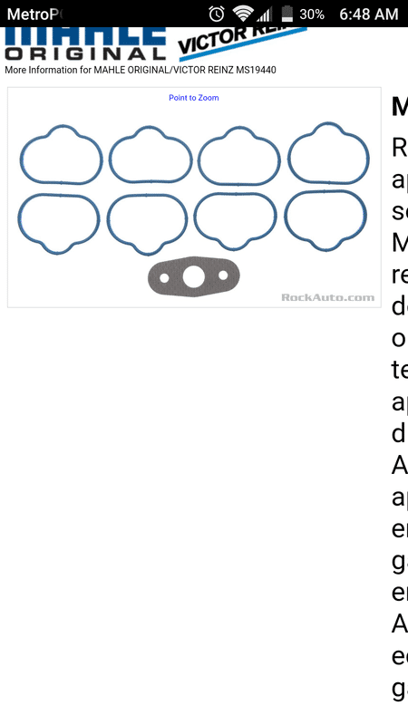

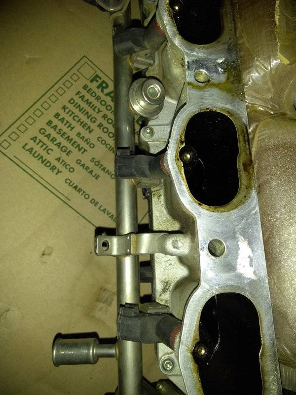

The gaskets should go between the plastic part of the intake and the metal part. you can't see them without removing those screws and separating the two metal parts from the plastic part.
What you are showing is the surface that mates with the heads on the engine. Those two surfaces take two thin metals gaskets, one for each side. These gaskets are 2W9Z-9439-AC.

Ok thanks for that link. I honestly think the best course of action is to leave it and hope there is no leak there.
I will get it put back together after the rest of the parts arrive, and once running do the spray test to look for any leaks from there. If there is than I will have no choice but to crack it open.

OK from what I've heard that part your looking at is not supposed to be separated and there's not even a replacement gasket for it I'm not sure if that's still the case though so I think someone opened it up and could not find a replacement gasket so they used sealant I would leave it alone the only gasket u should replace there are the metal ones that clip on to the bottom of the intake where it meets with the head but if you decide to open it up its always best to use a plastic scraper
We were able to locate some replacement gaskets for the metal-to-plastic seam of the intake (the individual cylinder gaskets with blocks). However, they were $130 or so. So I just remove the old ones, and put a bead of RTV on both sides of the old gasket and sealed it back up. This stopped all of my intake leaks.
