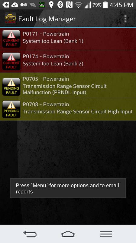

I posted a video of my intake leak, and got a quick reply about a brass threaded plug in the TB, and sure enough, mine was missing (well, it is wedged next to an injector), replaced it with another plug and all is well, I reset the CEL and will monitor it.
I was able to reach under the TB from behind and block the port with my finger and the leak stopped...before I pulled the TB.
I was getting P0171 and P0174 (disregard the MLPS errors, I have some wiring/connector stuff to work through, that and the TFT are reporting issues when it rains):
