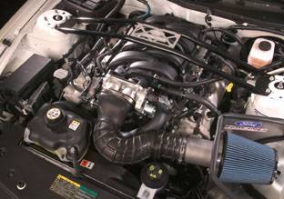

Dr. Paul, have you been a 1/4 mile track lately? Look underneath the hood of any EFI Mustang and most of them will have a conical filter, and most will not have a heat shield either.
I have made 23 passes in the last four days, and I own two EFI Mustangs. Moreover, I'd venture to say that I even know a thing or two about fuel injection.

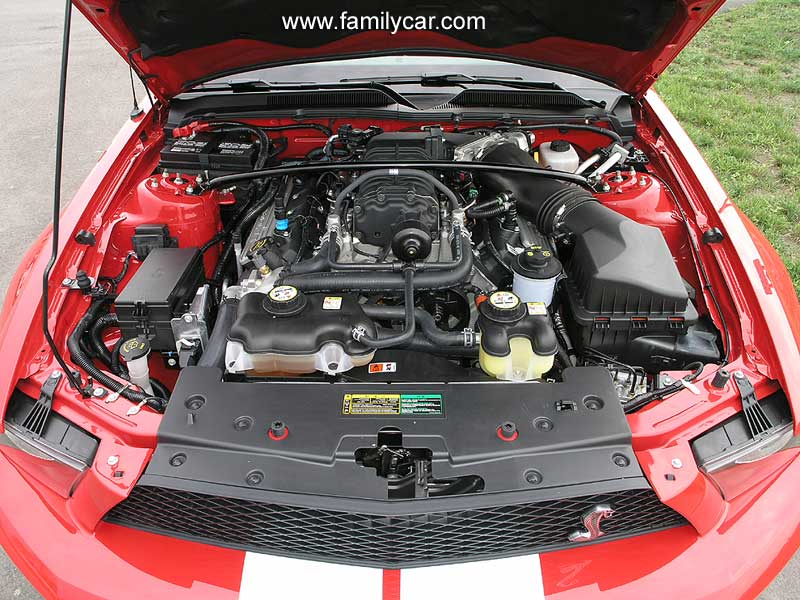

If it's such a bad idea to run a conical, why does Ford and Shelby have a stock conical filter on their new Shelby GT-H model?
It's not a bad idea to run a conical. I'm saying it should be shielded from the engine and fan.
Oh, and it appears Ford seems to agree:
Dr. Paul is right, no reason to run a conical without a shield. It's not like it's that hard to fabricate or buy one.
I noticed a big differance when I shielded my filter from my engine bay on my MarkVIII. I didn't have drivability issues that I was aware of though with the open filter.
My LSE doesn't seem to be as hot under the hood but the car runs fastest in its 50+ passes with a cool engine bay, not so much a cool motor.
As far as at the track most are cooling it down for the best times so running open isn't as much as a issue.
