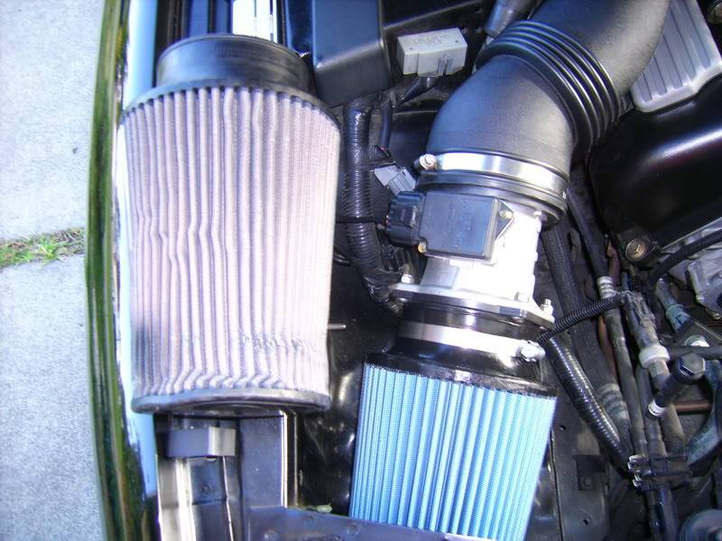

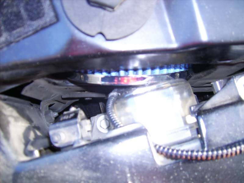

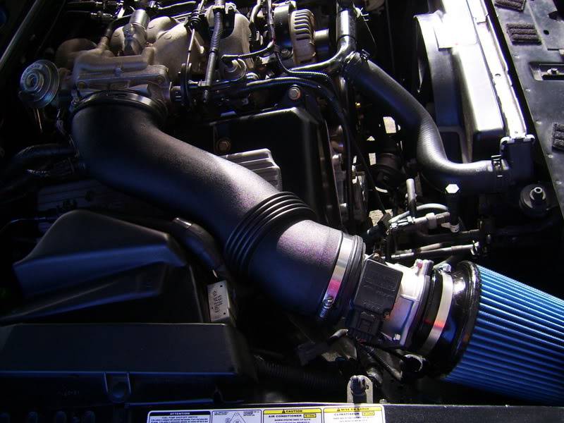

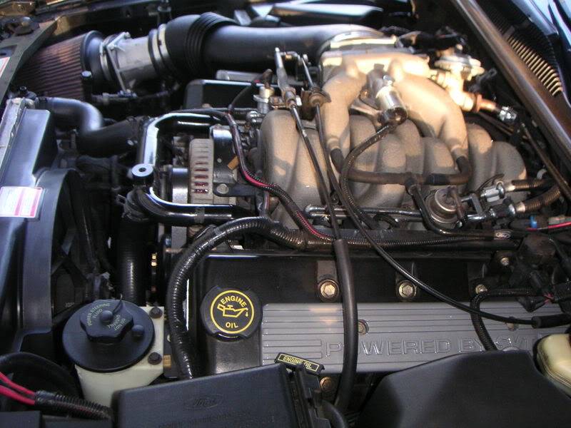

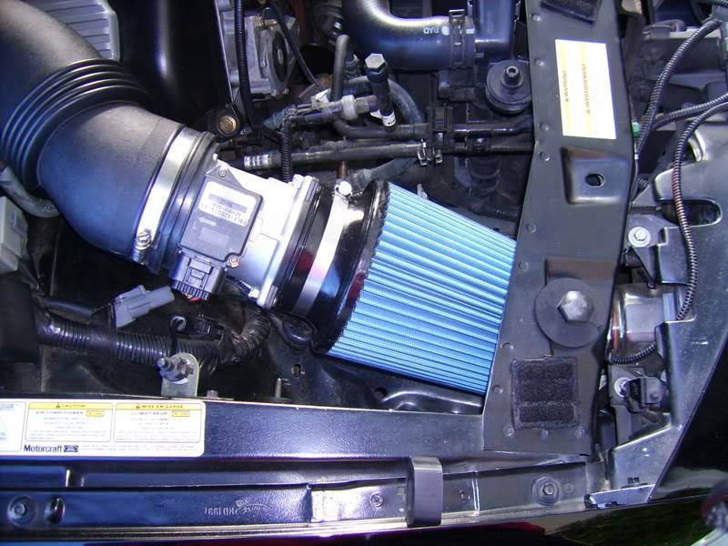

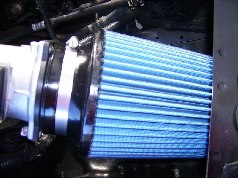

    It's a little bigger than my old 9 inch K&N, it barely fits and rubs a little bit on the HID ballast but it's not a big deal.
    Here is a pic comparing to my old worn out 9x4 K&N.
    The car sounds louder with the Amsoil conical and there is more induction noise than with the closed mouth K&N. I went WOT around the block and the car chirped the tires really hard on the 1-2 shift so it's definately not down on power compared to the K&N. The Amsoil is made out of nanofiber and doesn't need to be oiled, it's cleaned by using a vacuum or blow dryer.

    Why in the world do they make these filters such an ugly shade of blue ?

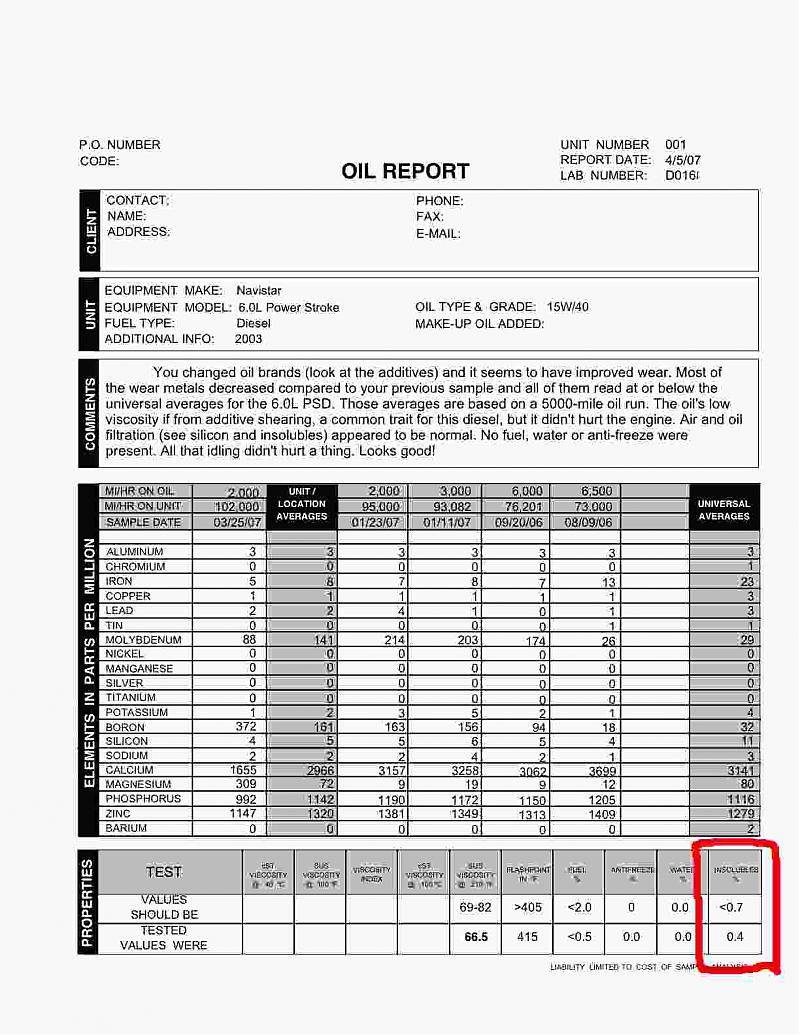

    No, I don't have dyno sheets and numbers. I can tell you this though. I wasn't looking for performance gains. The truck does just fine pulling what I need it to pull.
    I am however, getting a bit better mileage (around a mile/gallon), and my EGT's are staying about 50-75 degrees cooler after the filter swap. I didn't pick up 40 HP, or get mad torque after the filter swap. I wasn't looking for extra mileage. I wasn't looking for lower EGT's. I was looking for better filtration, and I found it.
    I don't have an oil analysis with the paper filter on this machine. I do however have it on my desktop. IIRC, I was pushing in the area of 1.0 in the insoluble department with a paper filter.
    Performance means nothing if your engine oil is chock full of dust.

    Hey, I like the blue color of the Amsoil conical... the red filters are way too common these days. This filter is Amsoil EaAU 4090, they have a bunch of different sizes.

    I wouldn't want an unshielded air filter in my engine bay. More hot, turbulent air to suck in and potentially disrupt the MAF transfer function.

    I have never had that problem, been running unsheilded for 10 years now without an issue. 15 years total with other vehicles.
    Please anyone else running unsheilded let us know if you ever had any issues regarding this subject.

    Never had a problem like that either. I am looking into get a heat shield though because I read some Mustang guys saying that the IAT doesn't react quickly enough and retards timing a little bit if the temps are too high. You will be half way down the track before the IAT compensates for the cold air coming in according to what I read. Realistically I doubt a heat shield will make any difference but it can't hurt.
