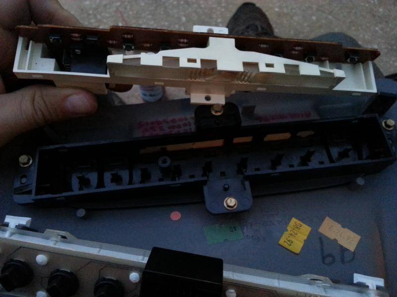

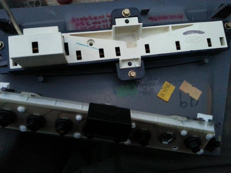

Since I bought my car the buttons were never responsive and I had to push them a million times before one would respond. Today I finally decided to open it up and look into it further and see if I could get them working properly and I did! First thing was to pop the panel up and pull it out. After it was out and upside down I was able to separate the top and bottom with a small screw driver as seem here: (8 slots)
After it was apart I had to use the same small screw driver to take out the light bulb and now in 2 pieces

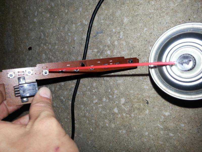

Next comes one of my favorite tools, circuit board/contact cleaner:
I sprayed each button and pushed them a few times and repeated for each button 4 times and now we are all working first time I press them. So much better and pretty easy to do. I hope this helps some of you.
