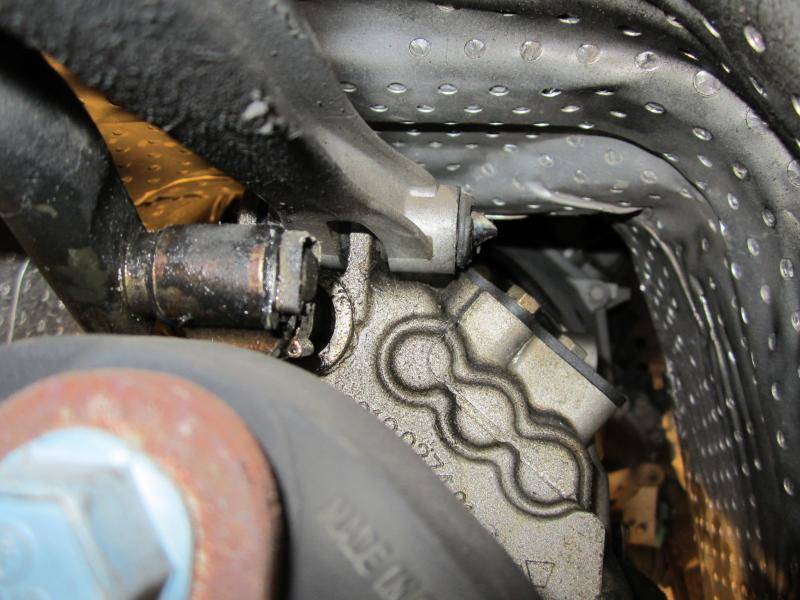

My transmission extension housing seal was leaking tranny fluid, and the dang oil was running straight to the transmission mount which got messed up due to it.
Seems like a common problem to have, my car has 150k. Neither Ford nor Lincoln sells that seal I did ordered at Ford, and the seal is not the one in the tranny. If u ever run into this problem, the solution is Napa (thank God for creating NAPA !!)
The new seal is in already, on the pics the Ford seal, and over the Napa box the original seal.
The OEM seal is made in Brazil, and the one Napa carries is made in Japan :cool:

Hey there LS6 5Spd, I should have written down the seal part number but figured I would just search the forum for your entry if I ever needed it. I've actually known about my tail shaft housing seal leak since last summer and had a transmission mount ready to install since the fall, but my lift access was not available for the winter and I just put this all on the back burner.
I got my @ss handed to me with search functions, and mechanicboy rescued me overnight.
Now I see why I was unable to find your post! Your username changed. How weird is that?
Thanks for posting this thread, and now, I have a seal on its way from a couple of states away through NAPA. Oh and thanks for changing your userid to something more memorable. I could see JESUS in the name but the other letters were not as easy to recall. And the search forum by poster function requires 3 letters at a minimum, so I was pretty screwed. I started searching over the weekend and thanks to mechanicboy, it ended overnight.
Mechanicboy says that a deep 30 mm socket is required to install this seal. What did you use when you changed yours?
Very grateful for both of y'all's help on this one!

About the socket, correct deep 30mm

Hey Mike, did u replaced the seal already? I lifted my car during the weekend when installing brakes, euros, sprintechs, links, etc. and notice the I still have a leak even with this seal.
I've still got a leak. It seems worse since I topped the Getrag off with a fill of new transmission fluid. I've had my car on the lift three times and I still can't tell where that leak is coming from. Shift rod seems like a good possibility but the transmission would probably have to come out in order to service that seal. What a pitfa, It's leaking so much that I have tiny dots of fluid accumulating on my back bumper. It leaves a good 4" drip mark every night.
Any updates Mike? Where is the shift rod? or what is it?
About our discussion on the upper ball joints, I took a look at them when we installed the stuff and you were right.. no way to press in ball joints and they do the job as the control arm has like a thick washer shape where the ball joint goes and it wont hold a pressed one. I will have to get oems but those I take out I will use to invent something, I will look for ideas and support here. I wanna find someone I know he builds rolex prototypes to have a better opinion/idea and hopefully help n support.
For what it's worth, I used a camera to check the condition of the shift rod. I just placed it above the driveshaft and pointed back at several angles since (obviously) you can't get your face up there. Saves removing the tranny for inspection. Mine has about 90k and the shift rod seal is just now showing signs of leaking.
