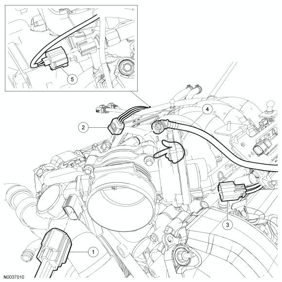

I stripped the threads loose in one of the intake manifold screws, do I need to find a new manifold? It's the 2nd gen v8.

The intake that is attached to the manifold. It's the upper right side bolt. I had to leave the car at the garage so I can't take the picture now. But the cylinder threads are no longer married to the plastic manifold

Okay, so that specific bolt holds the throttle body onto the throttle body adapter. The Adapter is all metal, so I don't understand the prior comment about plastic. Are you sure you are pointing to the correct one? Most people don't remove the throttle body from the adapter, instead they remove the adapter (with the throttle body still on it) from the intake manifold. There is a bolt kind of behind the one you are pointing to that holds the adapter to the plastic intake manifold. Are you sure it isn't that one instead?

You're absolutely right this is the wrong bolt it is the one behind this one, the one you mentioned.
