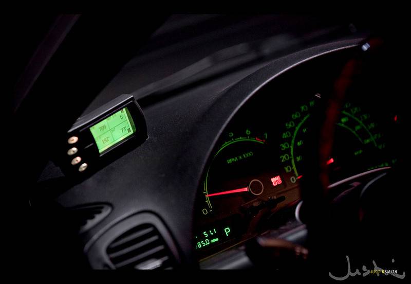

I saw a pic of the interior of your car, and that's what I thought it was. But then I figured it couldn't be, and chalked it up to sat radio or something.
Looks like it only works with gen 2's.
Somehow I missed your response.
Yes, the Dashcock will only work on the G2's because of the CANBUS integration. No CANBUS on the 00-02 cars.
