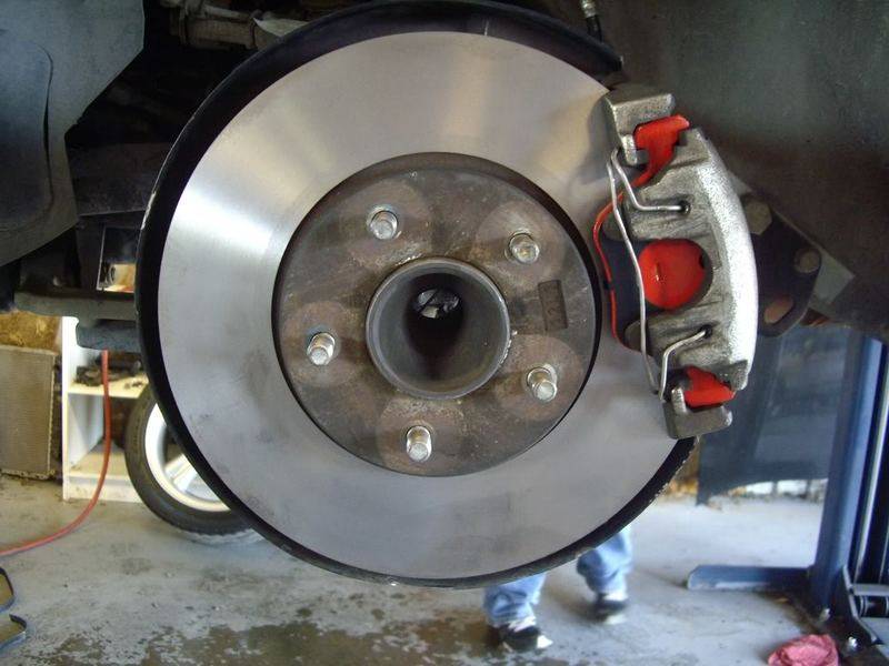

Turned rotors and ceramic pads:

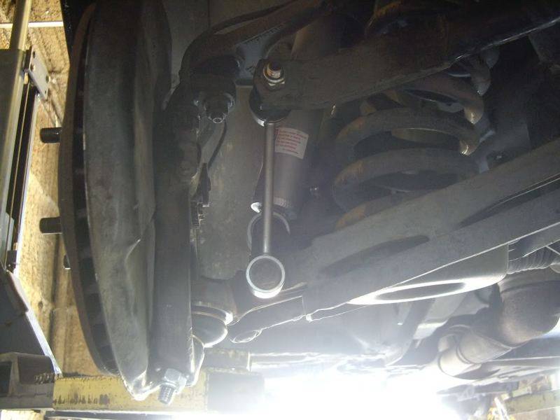

New ball joints, sway links and KYB HD shocks.

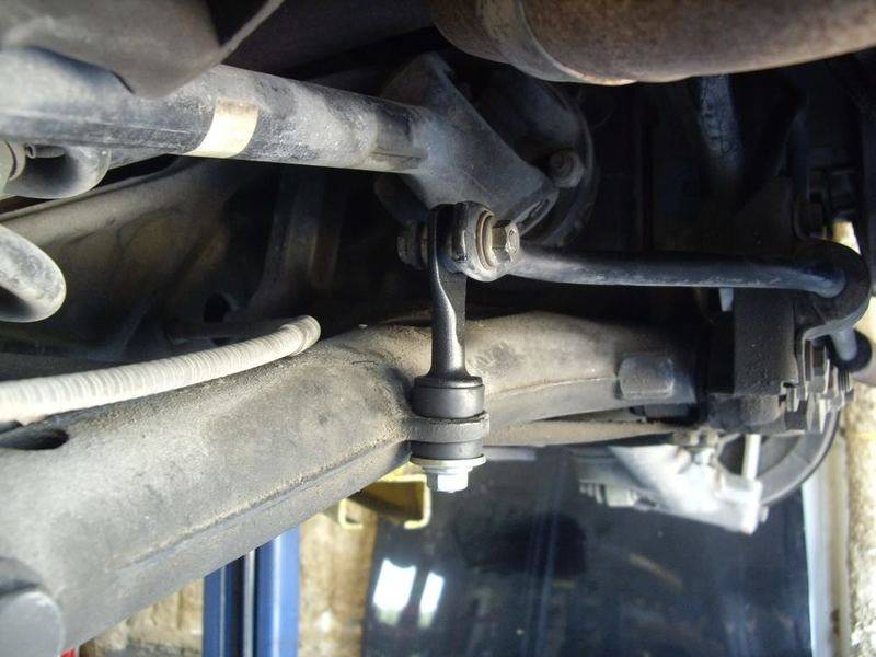

Rear sway links with a little modification:

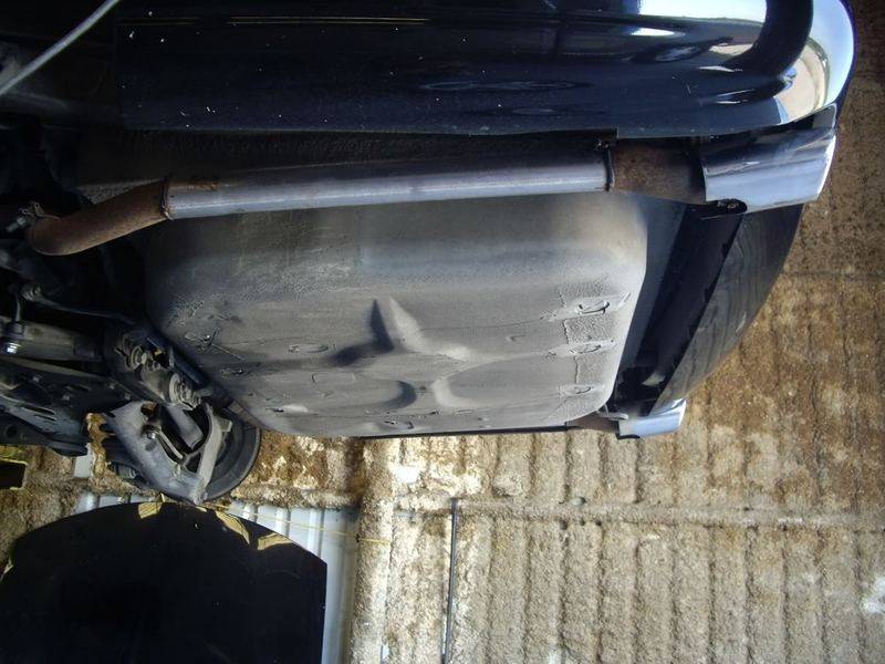

Removed rear mufflers and welded in a straight pipe:

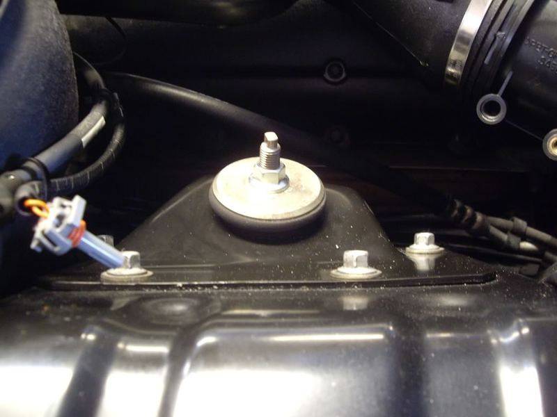

New upper shock bushings:

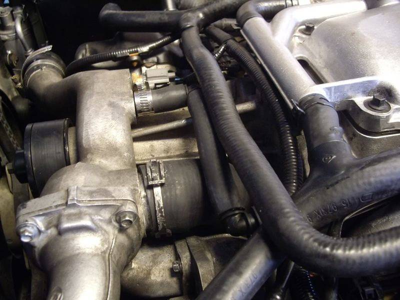

Replaced the water pump bypass hose and had to make a new surge tank hose:

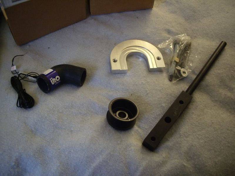

The Mina intake and Eurotoys blower pulley:

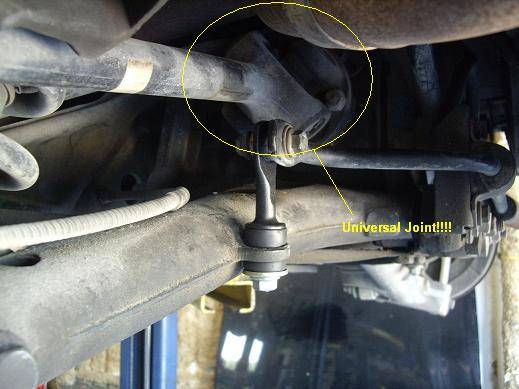

I learned something today.
The XJR has actual Universal Joints on the rear half-shafts instead of CV joints. Wow. I didn't know that. I prefer U-joints to CV joints any day of the week. I wish the Mark had U-joints. But CV's dont' give as much trouble in RWD cars as they do in wrong-wheel-drivers. But it's good to see a real U-joint in a RWD car like this. :)

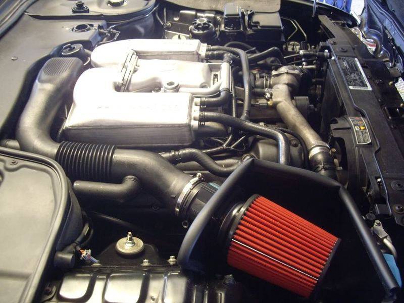

Dont think the car likes the CAI. Got a check engine light on the way home when I did a WOT blast.
And what a blast. Car is almost quick!
