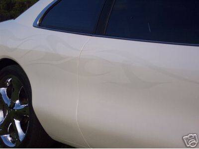

like this.......:D
that :q:q:q:qin sick man :eek: i like it alot
:shifty: now what poping kit did u use :confused:
