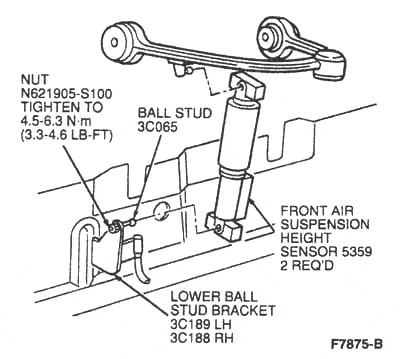

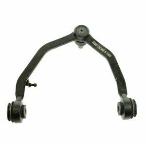

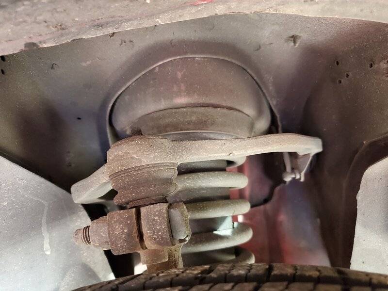

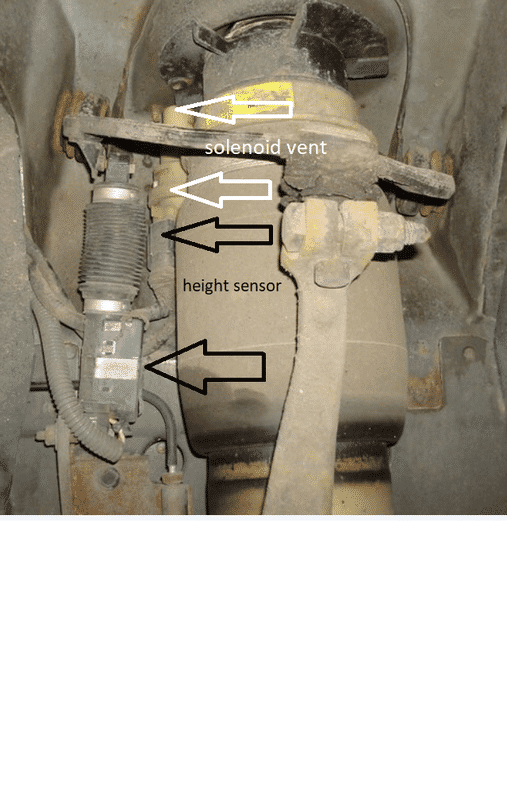

    If not, just pull the front right inner plastic fender cover off to look for the compressor. I'm sure the two processors (one grey, one black) are in the front right interior. These are located behind the kick panel. You will need the wheel sensors, if they were removed - a quick visual at the upper control arms will confirm - while you are there make sure you have little ball that the sensor clicks on to - some that switched to springs have bought Super Coupe UCA's as they are cheaper. These do not come with that ball that is welded to the edge of the UCA - the height sensor has a clip that attaches to it. You will have to get underneath the rear (middle) to look for a single height sensor for the back. Of course make sure you jack up the car using the proper rear lifting points and always use safety stands before going underneath.
    I just bought a set of Westar's for the front $339 usd, plus it will be free shipping for you in the USA. He only has two sets left and this is cheaper than the $214. for each at Autozone when they sold them.

    see article written by Kale. Thanks Kale!! Its for lowering, but will help you identify and locate parts. This with that other diagram I gave you should help you find all. if some are not there, you will need to replace them:
    Lowering Your Lincoln Air Suspension Sensor - Lincoln Mark VIII

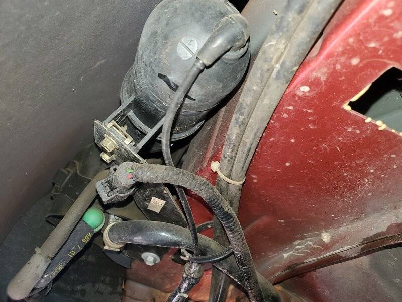

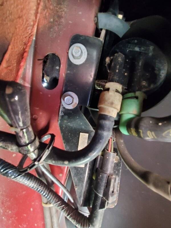

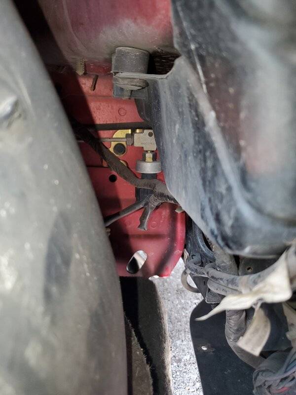

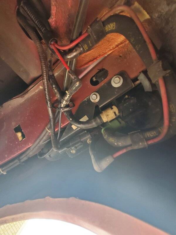

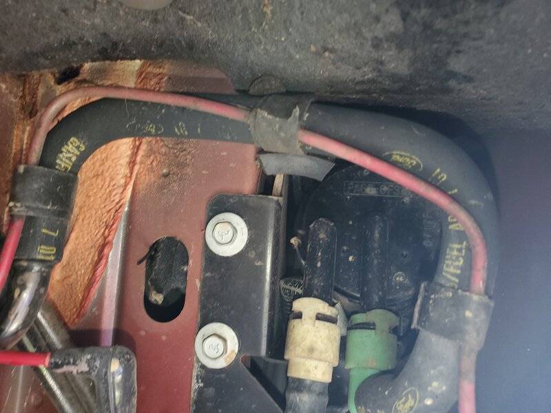

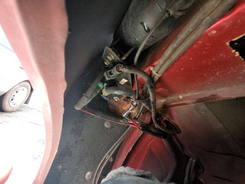

    No the previous owner to me was my father but we don't speak for reasons that are personal the owner before him has passed so no dice there either but I pulled the fender liner and snapped a bunch of pics. The good news is the UCA has the ball you were talking about bad news is when I pulled the computer dunses with the buttons that control the display one of the clips broke and the little strip that lights up the green track off light popped out but I finally got that part in at least.

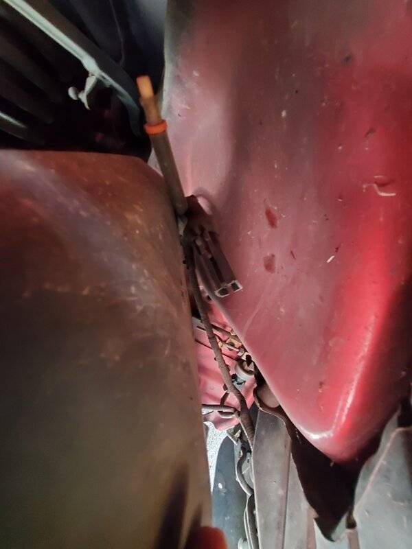

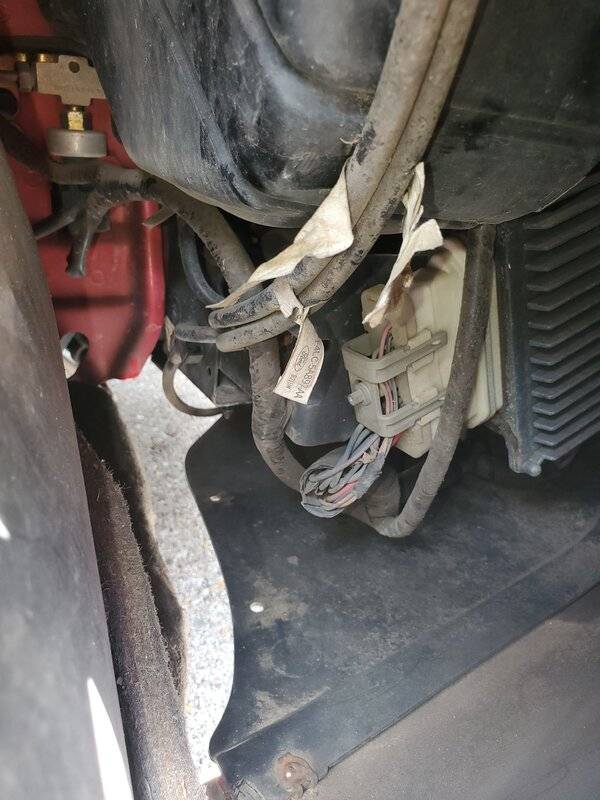

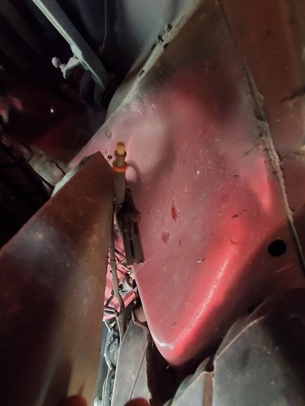

    20201016_123546.jpg 20201016_123527.jpg 20201016_123511.jpg 20201016_123453.jpg 20201016_123431_001.jpg 20201016_123403.jpg 20201016_123358.jpg 20201016_123242.jpg 20201016_123223.jpg 20201016_123220.jpg 20201016_122149.jpg

    I didn't know what I was looking for so I took pictures of everything, our landlord warned me if I jackup the car in the parking lot one more time she's gonna kick us out for breaking the rental contact agreement

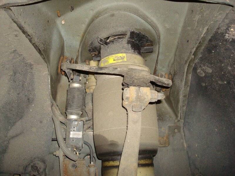

    hey, you ride hight sensor is missing in that last pic.
    • Like Like x 1
    • Ripco
      Ripco New LVC Member
      Messages:
      8
      Likes Received:
      4
      Joined:
      Jul 8, 2017
      Location:
      Chicago

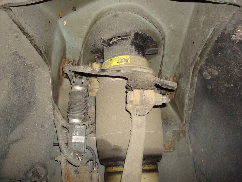

      This is sort of what it’s supposed to look like. 1997 mark and is the drivers side I think.

        The solenoid won't be there with the air shock removed, but at least gives you an idea. I have the lower black air dam that runs underneath off of my M8 from redoing my brake line, I will try to get you some photos of the compressor/air dryer, this weekend.
