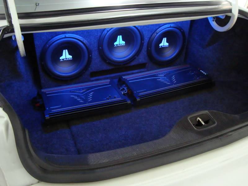

Believe this or not but the ZX1000.1 I have is wired at 6 ohms. Me and LaserSVT went back and forth, trying to figure out how it needed to be wired with my three 10's and it beats the hell out of them with very very little effort. I did have a Kicker Solobaric L7 square 12" and that amp was just a little too much for that thing IMO. I think the ZX750.1 would suit you fine and putting that 12 in the same location where Sapper has his is ideal. The bass has a good reflex, roll, bounce, w/e one wants to call it, from that spot.
My box is slot ported and it goes deep enough to sound like two 15's but they all three can produce the sound of a 10" with the right settings being set in the deck and the amp being set right.
If you don't listen to deep bass, then sealed would give you a nice clean kick and you would know it's back there. I don't do round ported boxes so, I can't even suggest there. If you do listen to deep bass, you'll need to make sure that it can handle that type of enclosure. The bass will be deep with a slot ported / vented box and if it's not done right, expect distortion. Most just go with sealed enclosures for a good tight thump in the trunk.

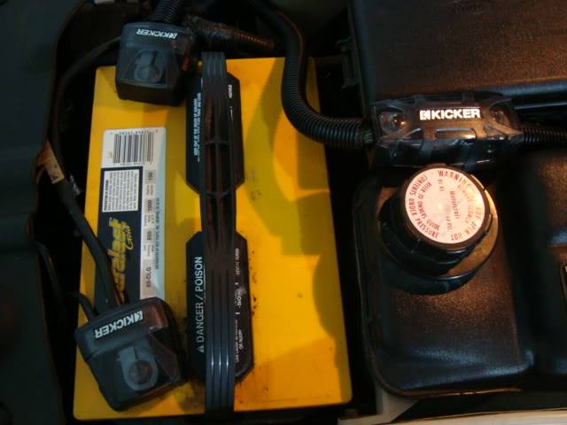

Within 12 to 15 inches of the battery, you'll need a fuse block. I went with this one and a 150 amp fuse.
Fuses alone. I have yet to blow one or have any problems with this fuse. I still have an extra one put up somewhere.
[url]http://www.ebay.com/itm/Kicker-ANL150-09ANL150-150-Amp-ANL-Fuse-2-Pack-/300798459765?pt=US_Car_Audio_Video_Fuses_Fuse_Holders&hash=item4608fc3f75[/URL]
Fuse block that will accommodate your wire and the fuse linked above is here. This was just my choice, doesn't have to be yours also.
[url]http://www.ebay.com/itm/Kicker-FHA-Nickel-Plated-1-0-4-Gauge-AWG-AFS-ANL-Fuse-Holder-/300798391129?_trksid=p2047675.m1851&_trkparms=aid%3D222002%26algo%3DSIC.FIT%26ao%3D1%26asc%3D110%26meid%3D3205919614123348713%26pid%3D100005%26prg%3D1063%26rk%3D3%26sd%3D261122821414%26[/URL]
That doesn't have to be mounted. Mine just lays right here and it never moves, or hasn't for the past 2 or more years.
