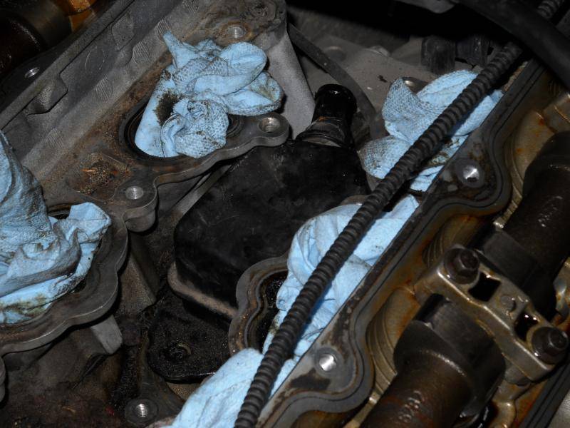

Now for the next question, I found the little black box that everyone was talking about does it come off to get the pcv valve off? I'm stuck trying to get the pcv valve off now any pointers would be helpful, btw we found a MOUSE NEST in my intake!!! Thanks guys....
Jennifer

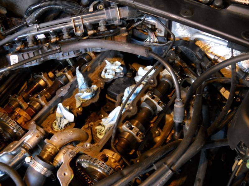

Pics...
Here is the pcv valve...now how exactly do I get it off?
Thank you all for your help!
Jennifer
